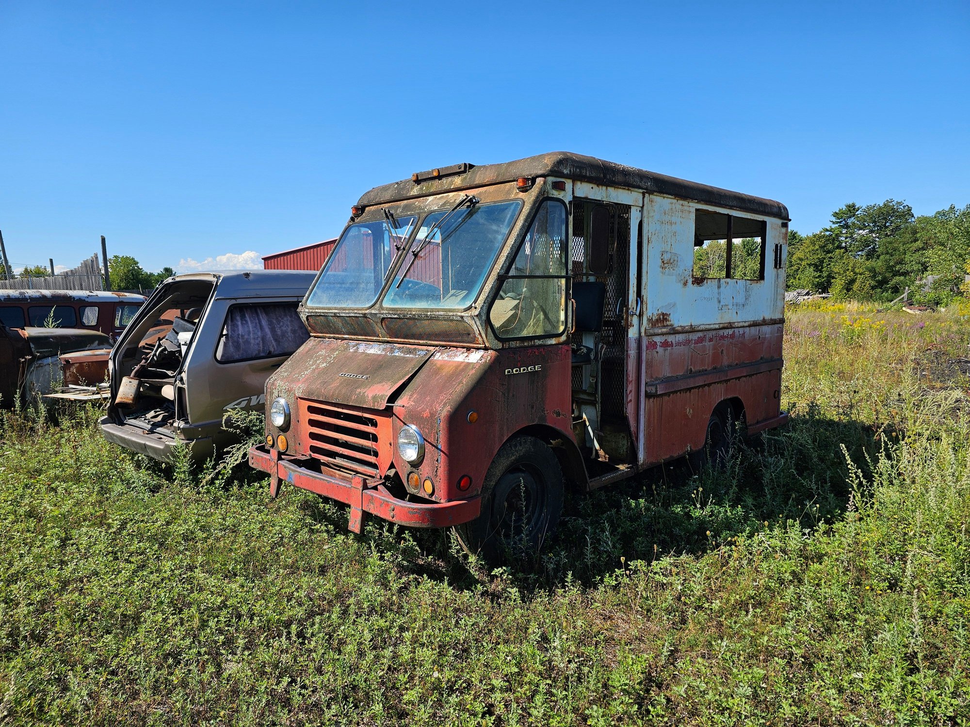

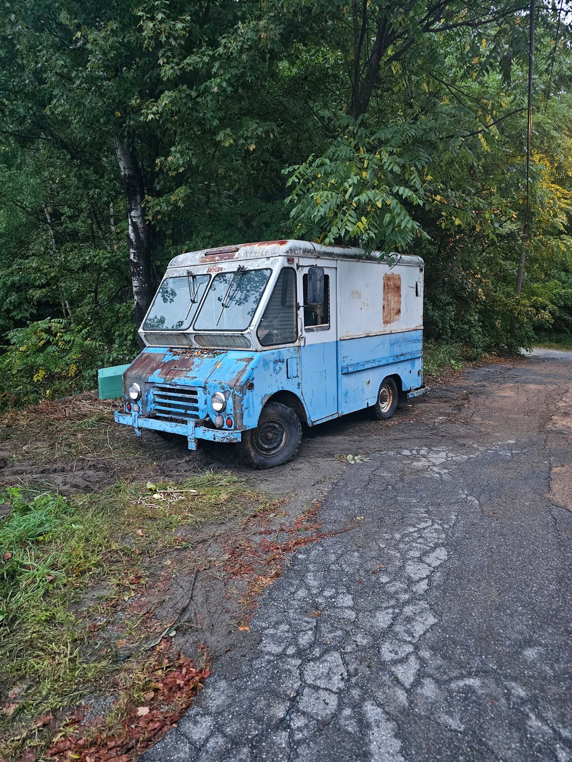

New member here, I just picked up my very first Chrysler product, actually 2 of them. I found a couple P200 postal vans on marketplace locally for very cheap, and dragged them out of the woods where they'd been sitting for the past 30 years.
The current plan is to fix up the blue one to go back on the road, and the red one will donate some parts the blue one is missing, and will probably get sold later on. Right now I've just started working on the blue one, and after a couple hours work, a new coil, and new ballast resistor, it starts reliably, runs smooth, and will drive around the yard. Next up on the list is all new brakes front to back, new fuel system, and some cooling system work, along with wheels/tires.
Currently I've got a few questions, but I'm sure I'll have more as I go through it. Does anyone happen to know what bolt pattern the wheels are, and what size rims it would have had originally or if I can buy a set of say, Ford rims and use those? The blue truck has 16" split rims which I doubt are original and will be replaced, and the red one has 19.5" steelies.
