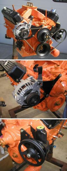

I had to have the Alternator bracket on my '77 Winnebago ( D400 Chassis ) welded back up. Since I LOVE to procrastinate, I forgot how it all goes back together I think I have it back right. but is there anyone out there with a 440, NON air car that can post a good pic of the Alternator? I'm either supposed to bolt into the cylinder head, or am missing a nut. It's the bolt that has the pointy end that goes through the triangular looking bracket.

Thanks! Unfortunately, the heater hose, and angle are wrong for what I need. If I could get a detail pic of this area, all will be right with the world
***EDIT***
I think THIS is what I am looking for If so, I think mine is broken in the head

Sorry tied up last couple of days...I'll get a pix tonight! If I recall it goes into the head then then a spacer between head and alt and then small spacer then the bracket.
Old Aug 6, 2009 | 03:51 PM
the 440 has a spacer that bolts into the head

found this pic in an old mopar action. It might help
