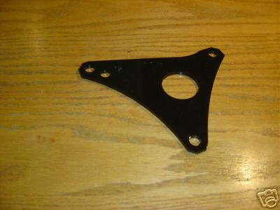

Could you take a picture, could be a bracket issue or something like that.
Old Nov 5, 2008 | 07:14 AM
you could be missing a spacer or using the wrong bolts. If the pulley is off that much, then don't use it.

Does your bracket look like the one in this picture:
Note that there are three parts to the alternator bracket; 1 the part that bolts to the head, 2 the part that bolts to the piece that bolts to the head and holds the back of the alternator, and 3 the big piece you see the most of that attaches to the 2nd part and the water pump, it has two bolts on the front of the alternator.
From what you are saying it could possibly be rigged without part 1.

That is the front one, and it does not attach to the water pump housing then?

the bracket you show in the pic could be the wrong one as there is two different one that look the same but the bolting holes are longer apart , you probably need the longer one to get it up to the farther out hole on the water pump housing or it could be you need the one like c has but we need to know the year of the engine to be sure ok
