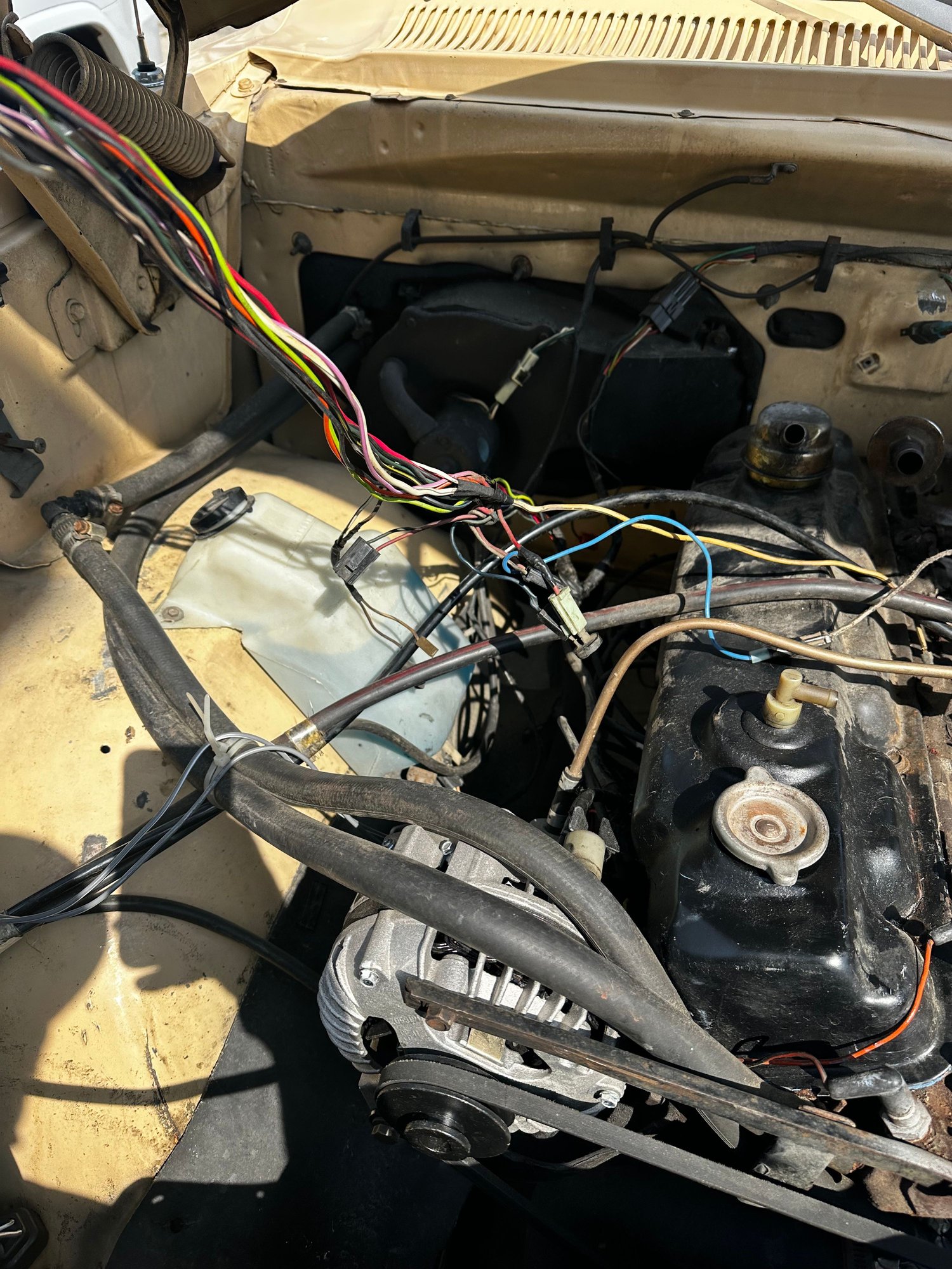

Ok so I started installing the new distributor and ECU box. Think I figured out the HOT 12v and START 12v. But what about the alternator wiring and such that goes to the aircleaner leanburn junk All this wiring I want to get rid of. Its it possible

THere is two big connectors that come from the Lean Burn like this

But there is wires coming for this wiring harness to the Alternator

And What is this thing

Bare with me as I look over pics of something not tangible. But.... yes you could eliminate the lean burn crap. A regular electronic distributor along with a carburetor for that engine which looks like a 225 without lean burn will work in place. The alternator has a hot wire going to the 7/16 inch nut on the bottom to power it up. the other wires without standing in front of it leaves me. Try not to lose sight of the basics of that engine. Spark which is easily gotten by the electronic distributor and of course the basic carburetor. Sorry I can't be more help.

There is 4 wires soldered together (Hot Wires) the One hot i thought was the 12v constant was the coil wire, lol. My question the Alternator wires and sensor wires as of right now. I have the Distributor in the ecu mounted and grounded ( BUT at an angle). I just want to cut and hack this old wiring and have functioning oil and coolant dummy lights and obviously the amp gauge working. PLUS the alternator working properly.
Any body have photos or wiring diagram. Patiences is key here LOL

Ok, Just reading more The regulator is what i took off thinking it was an Old ECU.

Can I use the four wires that are soldered together on each side of the Ballast? I can not find another 12v ignition wire other
then these ones
Old Jun 25, 2023 | 10:00 AM
Posts: 11,104
That should work...

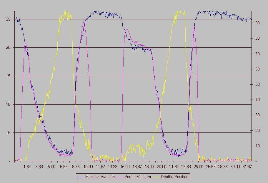

The difference between ported vacuum vs. manifold vacuum is the connection leading to above vs below the throttle plates.
Ported vacuum is above the throttle blades and should only apply vacuum when off idle. (If you get vacuum advance at idle while warm your engine speed is set too high).
Manifold vacuum is below the throttle blades and will apply vacuum at idle. That is the only difference.
You can use a vacuum gauge... honestly probably even your finger to confirm which is which while the engine is running. You'll need to have vacuum advance plugged off anyway while setting initial timing.
