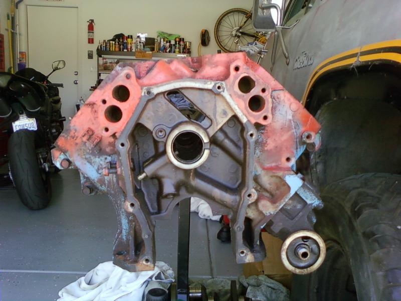

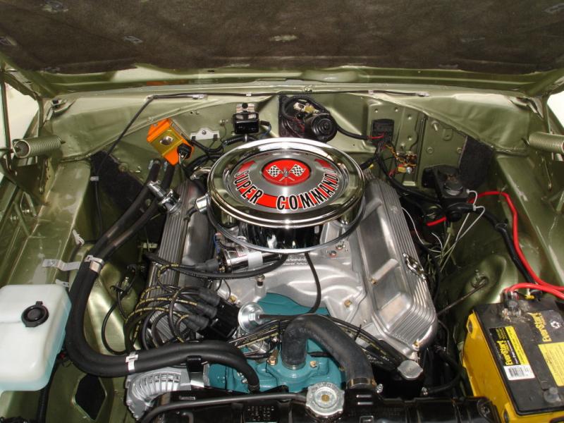

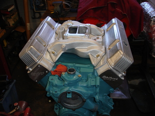

Sorry guys it's been a while since I've been on the forum. Just wanted to update you with the progress of this engine build. I can only go as fast as my budget allows. Here is what I have so far. The block was short blocked at Las Vegas Machine shop. I traded out the cast crank for a forged which was internally balanced. I have speed pro pistons .030, Isky 264 megacam with .300 cam lift .450 valve lift 264 duration. I have Edelbrock performer rpm heads and manifold. 440 source roller rockers and timing chain cover. Indy valve covers and ARP bolts everywhere. There is a Moroso pan on it now but I have to Change it to the milodon cause its goin in my PowerWagon and I need a rear sump. I just order the oil pan E3 plugs and a set of Hedman headers. I'm not sure what carb to go with yet. The guy at 440 source says to run a holly 750 double pumper, but with all the edelbrock stuff I was thinking an Edlebrock carb. Any suggestions??? Putting some pictures up as well.
