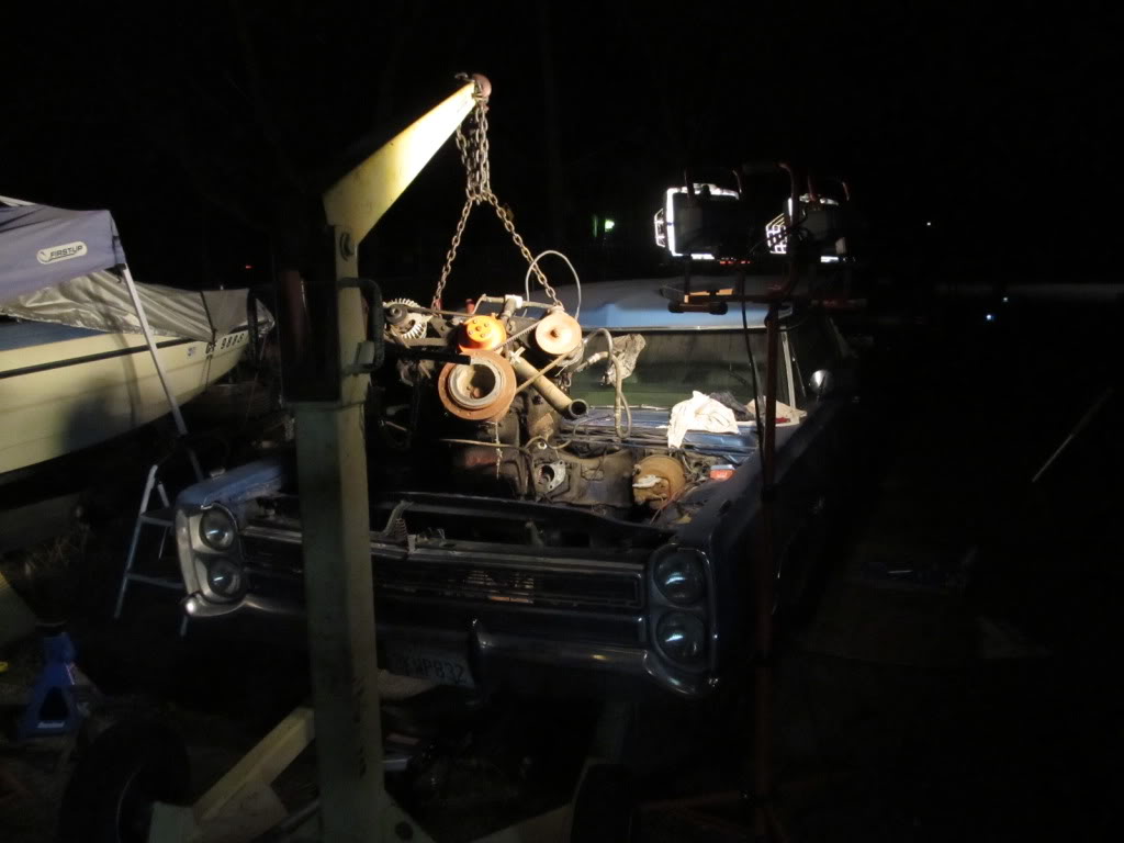

I blew the 318 in my ’68 Fury quite a while back, and I finally have some and time to put into it. I have never done a build thread, so I figured it’s about time I started one.
The engine coming out of the patient:

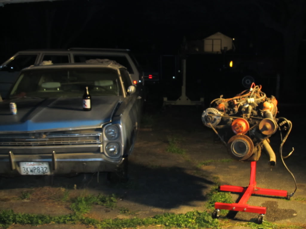

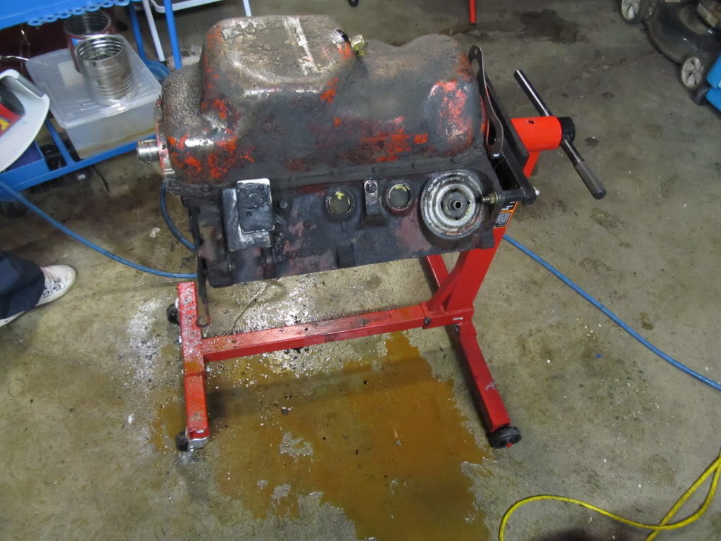

Finally got the engine on the stand. It was sort of a debacle because I had constructed the engine stand backward on accident. When we tried to drop the 318 down, the engine stand buckled and we couldn’t figure out why. By the time my buddy noticed my error, I had welded on it and... oh, it wasn’t fun.

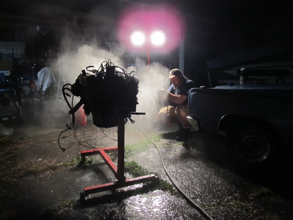

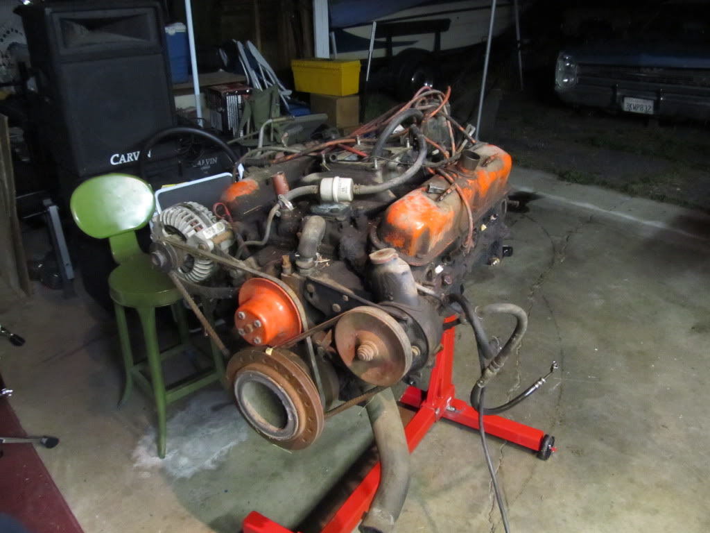

Here’s the 318 before we shot it with two cans of de-greaser and took the power washer to it. 350,000 miles of road grime was a challenge.

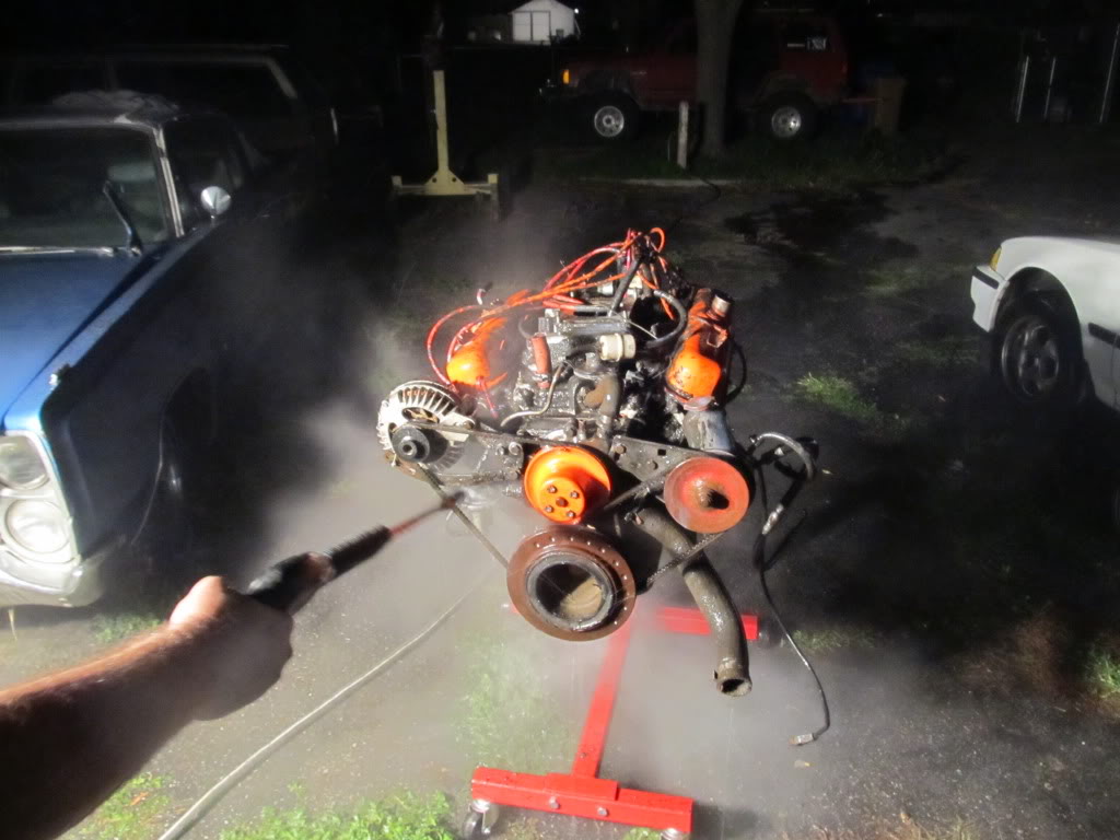

I’d had a couple beers by this time and decided to try and get artsy with the camera. The shots actually came out pretty cool! Bath time for the little engine.

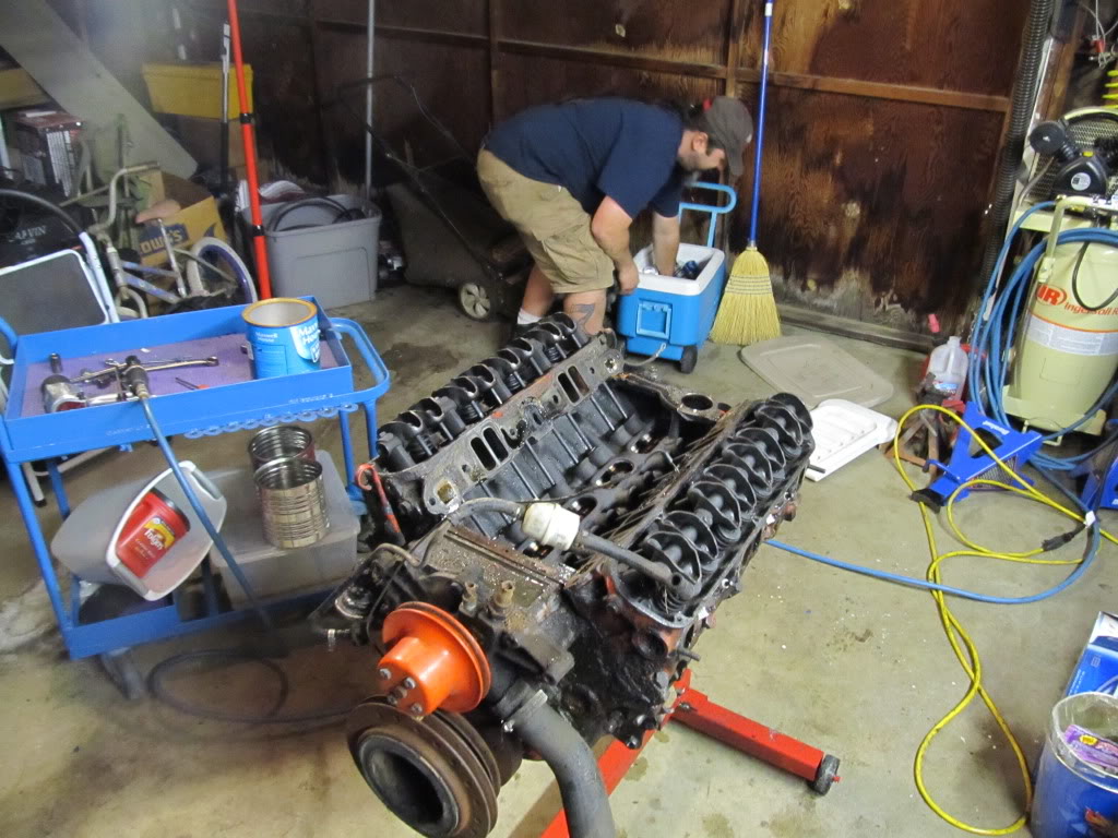

Here is the 318 starting to come apart. My buddy needed a little more engineering fluid, so I was able to pause for a shot.

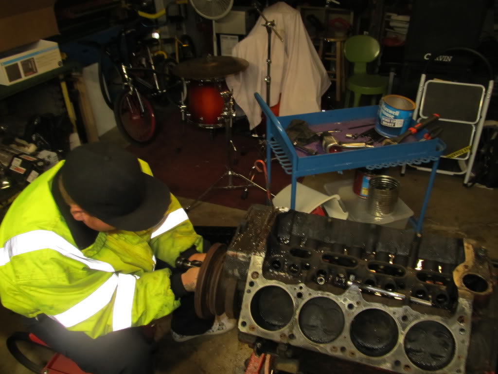

My buddy working on the front pulleys.

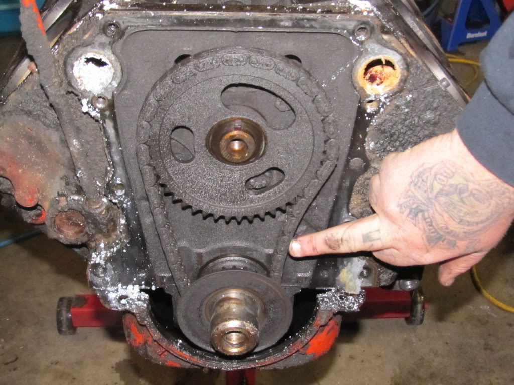

I know for a fact the timing had jumped at least a tooth because a gun was useless. I had to time the thing by ear and feel, which hastened the 318’s demise. This is why 20 year old kids shouldn’t be driving cool cars. :P

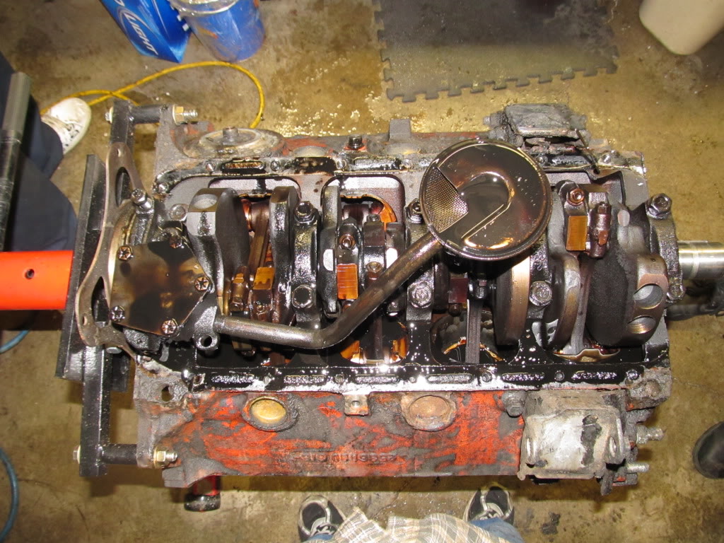

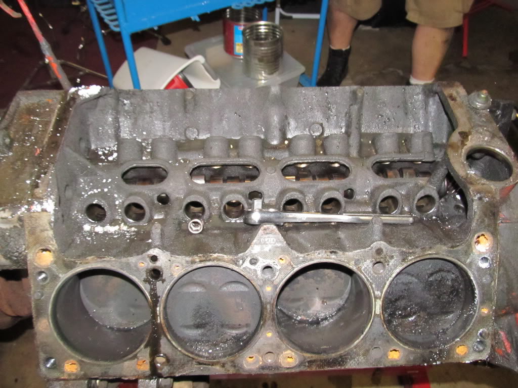

Almost time to see what the heck happened when I lost all oil pressure and heard a deep, hard, knocking sound. I figured I had spun a bearing when the oil pump went, but that wasn’t the half of it.
Everything looking okay at first glance. Not great, but nothing deadly.

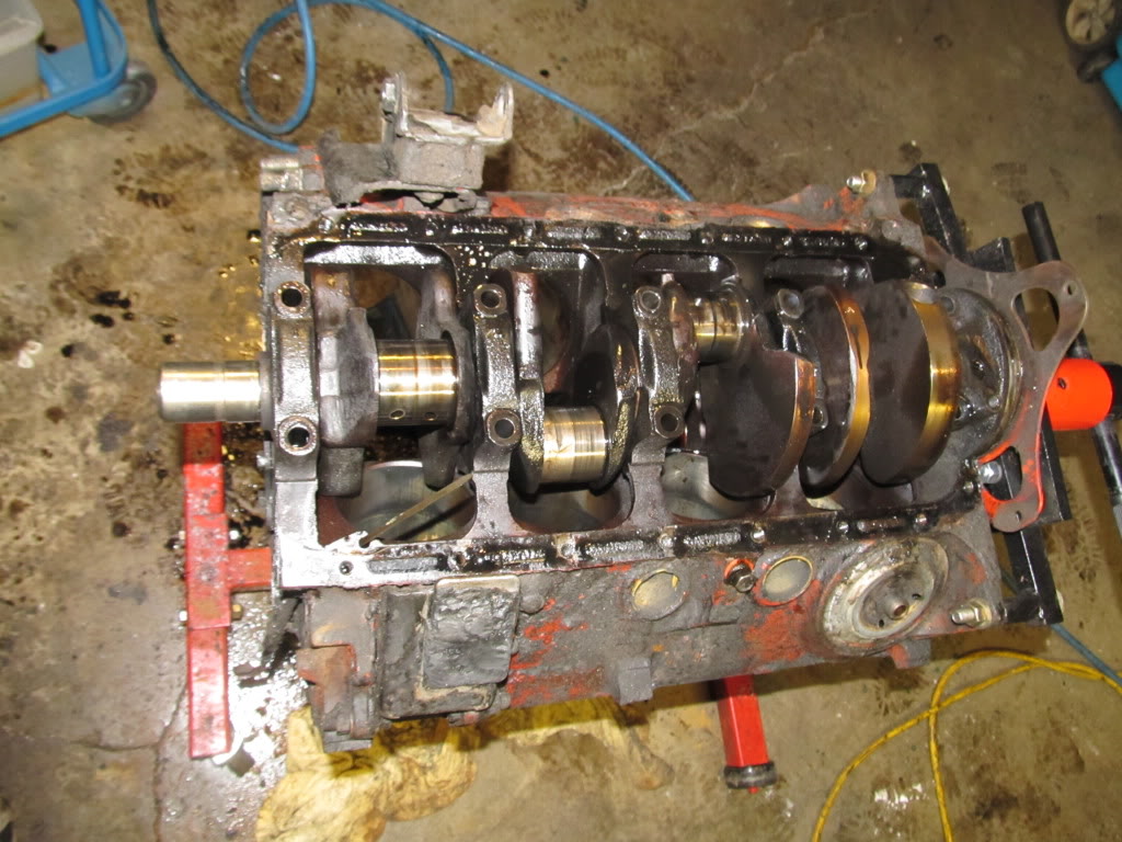

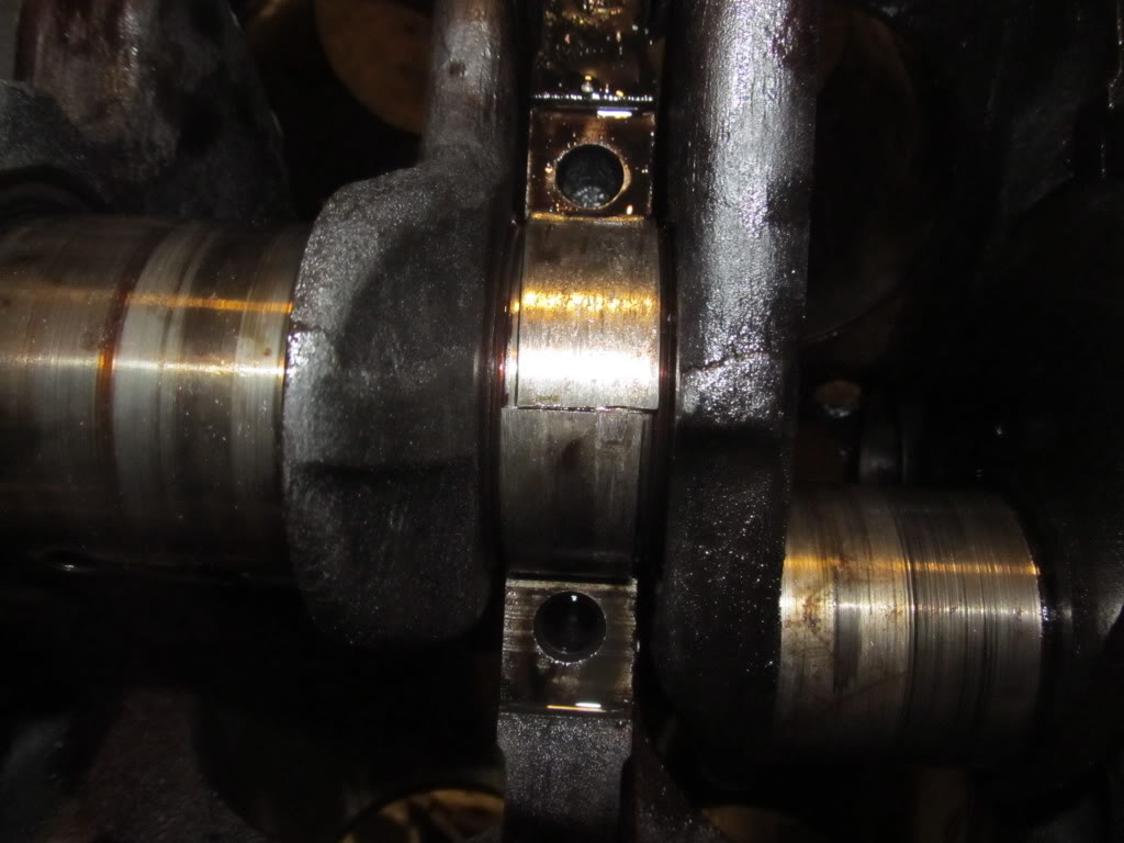

Then the monster showed itself. I was right with my diagnosis: The engine had lost its oil pump, and I had spun not one or two, but THREE bearings. They all looked like this one.
Due to the damage the bearings did to the crank, I’ll have to have it turned for sure. You can see on the right there, the grooves that are present. That won’t get me ten miles on a rebuild.
