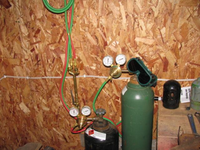

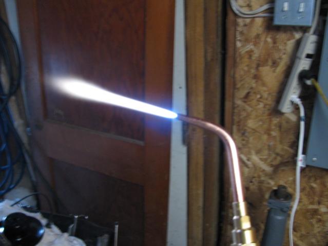

Thanx, I usually hear the opposite.
and Yep, I never liked stock so it will have all kinds of little things that only my car will have. I will keep you posted. Right now I am teaching myself how to use my new oxy acetylene set-up. I love the fire knife, it's old school just like me.:cool
The motor I bought out of a truck for $150.oo ( still have the truck specific parts.) is a 76 400 bored .040 with flat top pistons to raise compression, and reworked stock 452 heads, it has an R.V. cam ( lost spec. sheet) Intake and carb are 66 afb from an old Polara wagon with a 383 I had back in the 80's Trans is a 74 727 that I built myself. Being a 74 it has the part throttle kick down not available in 68. The dual inlet air cleaner came with 68 H.P. 440 that is still waiting it's turn for a trip to the machine shop. It didn't fit the small afb but with the stock bottom plate and a tall filter it is basically a stealth open element air cleaner.
Attached Thumbnails What project are you working on?-torches-001.jpg   What project are you working on?-flame-002.jpg   What project are you working on?-hmmmmm-002.jpg

bboogieart - that is a pretty nice setup. My fiance's grandfather is giving me his old setup soon. They come in real handy.

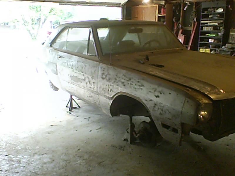

okay this is what i am working on
My 71 Dodge Dart Plans 418 storker motor 727 and plans to mini tub it also.
Attached Thumbnails What project are you working on?-rca_0015.jpg   What project are you working on?-63.jpg   What project are you working on?-th_027-1.jpg   What project are you working on?-th_rca_00622.jpg

Sounds like a great sleeper project.

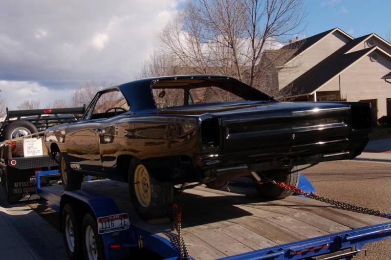

My 69 Project
Three years later, I have finally got the body and paint done, turned out quite nice, now its put it back together time. Time and money never enough of either. Regards CD
Attached Thumbnails What project are you working on?-dsc_0311newpaint-edit.jpg

Clay Dots - Very nice!

I like the black.

Thumbs up Thanks Guys! Tim/ 67GTX/ Boogie
For the kind words on my black 69, I wasnt sure this was ever going to see the light of day as every panel was damaged or rusty. Replaced the rear quarters, wheel wells, rocker panels , trunk floor & extensions some of the floor and other odds and ends like rear window corners etc.. Really liked black and hoped to get it straight enough. Luckly I know one of the best body and paint guys in Idaho hats off to Reid Fitch of Clear Classic Restoration .
Never give up and enjoy the journey, hope to acually be able to drive this car someday, soon I hope. Best Wishes!

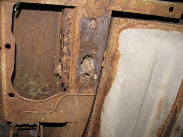

Actually 1x lumber is fine, unless it is spread out quite a bit. It is thicker than most plywood used. Actully most contactors around here use 15/32 osb. 1x Lumber is a good 5/8ths inch. Used to be 7/8ths when I started in the lumber buisiness, but everything is getting cheaper and costing more. It has held up on my roof since the early 70's just did the reroof two years ago and I should have taken the old shingles off (doh) but the roof itself is solid. Sounds like you have some work to do there. I would love to be able to rebuild rears but tool money is limited and I am still practicing on the welding. At least I can do my transmissions. I took the trailor hitch off the Chrysler last week end and found some nasty rust under it back by the bumper supports. Looks like I am gonna need to weld.
Caleb I wish I had frame rails too. It lasted a long time considering I drove it in the winter a lot in the early 80's well into the 90's. I sold the grill and hood off it to a local guy that thought the body shell looked great (for Wisc) I don't have the skill to install new frames. So here we are.
Attached Thumbnails What project are you working on?-trailer-hitch-68-009.jpg   What project are you working on?-trailer-hitch-68-018.jpg
They do look pretty bad. On my 40 Ford pickup I restored not too long ago, I had some bad spots on the frame that were completely rusted out. I cut out all the rust and welded 3/16 plates on the outside of the frame. I completely welded all around the plates I put on. You may be able to do something like that on yours (if you can get to it without taking your frame rails off) That way you won't run into any alignment problems. It's not exactly the "right" way of doing it. But it works and will probably be a stronger frame than it was to start with.

Caleb the above pic's are of my Chrysler. I will be fixing them. The Coronet frame rails are completely gone. nonexistent. The car is setting on the ground and I need to get it on some blocks or something so I can dismantel it further.
Good start Boogie! Yeah, looks a tad hot. What rig and set-up are you using for the welding? Your tack welds looked good. A bead of those all the way around would do the trick too! I'm only about 10 minutes ahead of you in welding experience!
Thanx, I agree that spot welds will do the trick. Kinda like a stitch welder. I do have trouble with being patient though. Practice practice practice.
It is "Radnor" on the gauges and in the box but the dealer I bought it through says it's a victor. Model numbers follow;
fuel gauge is RC-250-15-510
Oxy gauge is RC-250-80-540
torch WH270FC-v
filler rod 1/8" copper coated steel (RG-45)
fuel set at 5#
Oxy set at 5#
I am having trouble finding accesories for it though.I want smaller tips to try on the mild steel pipe like say 000 (.022), also I want a number 4 (.073)tip to do heavier steel, but all I can find is the number "0" (.035) I already have. I don't find any bigger cutting heads either.
I think I got a hobby kit, but it was all they carried when the was burning a hole in my pocket. The old set I had years ago was twice as big (?)
I have done some more spot welds but I was thinking a smaller filler rod would be a help as it does not melt as fast as the pipe I am working with.
All I can find is 1/8" rod. Not a lot of options local though. I have to go back to the gas vender today any way as I had a little exctiment yesturday. As I was welding on the pipe, I was making a few sparks. Didn't think that was right, when I took the goggles off I saw the shut-off valve on the accetalene tank had a small flame walking around on it. WOW I turned it all off fast. The guy said he doesn't understand, as that shouldn't happen. He is going to replace the tank today. I will have to order more tips and filler rod then, as he is the only place I seem to be able to get supplies. I will update soon.
Thanx for all the advice and encouragement every one.
