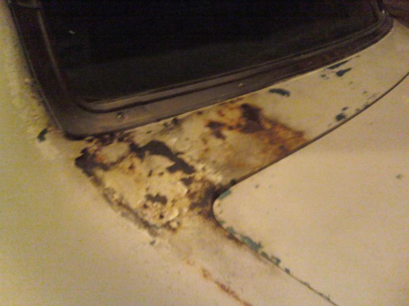

heres the rust.
its not rotted. its just really really dis-colored because that's were the tarp was rested with water on it.

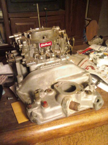

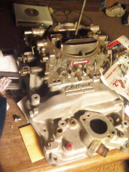

but, if everything goes smoothly, and i dont need rings, i should have that 4 barrel set up on in a couple weeks or so.
here are pics of the intake. couple questions. where would find, and what would i call the gasket for that metal piece for the coolant that geos in the front of the intake manifold. also, on the 2 barrel the fuel line screws into it, how would i make that fuel line fit this carb?

are your heads coming off to do the seals ???
if so give everything a really good clean .
if you heads do come off can you afford to mill .020" off the heads & mill the manifold to suit ?? call for a quote ? get hank to lap the valves lightly also . can you get a die grinder ??? if not can you get some stones for a drill ??? i you can you could lightly grind the inlet opening to your head . a little bit you could grind .020 " off the top & two sides of the port window as far down as you can reach . not to much though . you almost can't stuff it up if you only do it a little bit . just make sure you do the same amount to each one . i don't really recommend that you do the bowls though . thats best left for some body that knows what there doing . you could how ever ask a machine shop how much to mill your heads .020" & a light bowl blend to your inlets . I'd say $100 -120 might get this done . that plus your carb & inlet manifold would a little bit of performance . if you already have headers & 3" exhaust . you should pick up as much as 20 + hp .
