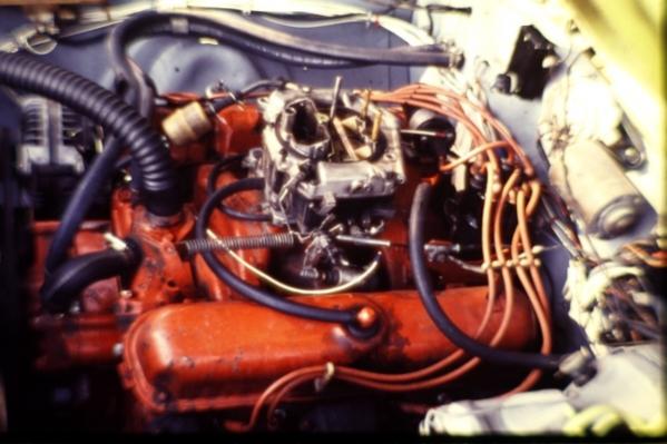

I put a 71 340 into my '70 sixpack RR body in about 73 or so. So this is a heavy car, Dana 3.54, A833, "hang on" after market A/C. It would get an honest 17.5 on the highway. I was not all that careful a driver. When I "got on" the freeway, I GOT ON the freeway.
Engine photo is right after it was installed. I was broke, and had no money for "chrome." Next is young skinny little me

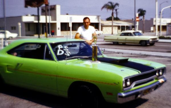

Bottom photo is before I owned it. My good friend George, who had just trophied in pure stock probably at Lions. I bought it from him with 35K on the clock. The original engine broke the no6 rod, broke the cam (in about six pieces), drove valves through pistons, and a rod out the block. I removed the intake, distributor, valve covers and threw the rest in the garbage.

Putting the 340 in was interesting, because only 318s came in 70 B bodies. The mounts are a little different, I had to use 318 single exhaust until I could afford headers, and had to turn the bell register larger for the 18 spline retainer. This was before "Al Gore invented the internet."

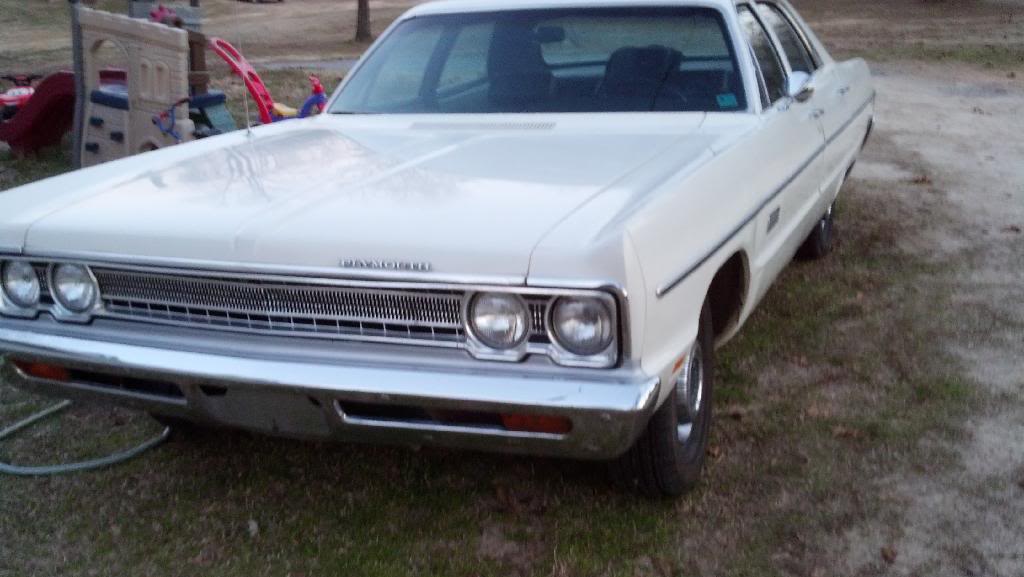

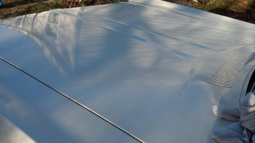

Bought all original with 28,000 miles. I have 31,000 on it now. Only replaced tires, shocks, motor mounts, belts,exhaust.gas tank floater.

.... Your going to have to put your foot in it a lot harder to get worse gas mileage than that !!!!!!!!!!!!
Good for you... I bet that feels great? How dose it drive out on the open road for you?
Good Looking car for its age... Well taken care of......
