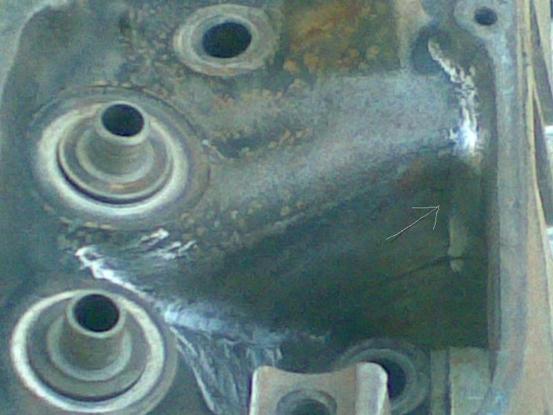

Last edited by deadkelly; Jun 8, 2009 at 03:42 PM. Reason: if you look closely at the roof you may see how i've pushed the valve guide back about 1 inch . the head is upside down

Last edited by deadkelly; Jun 8, 2009 at 03:46 PM. Reason: in the end that bump on the roof was flatened out .

Last edited by deadkelly; Jun 8, 2009 at 03:53 PM. Reason: all the work was done to the roof & side walls of the exhaust , especially blending the seat to the wall

finaly finished porting
wow that was around 35 hours total porting I'm glad that's over . fingers crossed it doesn't crack once it gets hot .the previous photos were after 10 hours that's when i thought i finished the 1st head . i spent around 4-5 hours today deshrouding the combustion chamber . i can now see why that is so important , i almost wasn't going to do that . well i'll let yous all know how it goes no doubt .

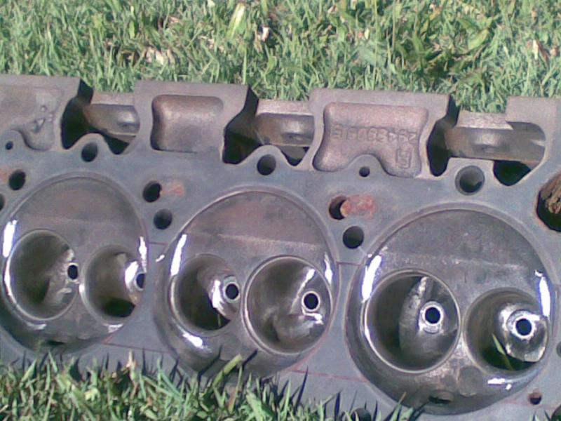

yippy ki aye . these are finished now as far as porting goes . i took the heads back down the machine shop today . well the photos aren't the best but as you can see there's heaps more volume , with 492 cid they should work well fingers crossed .

Nice job in the runners buddy. I can tell it's not your first set that you p&p.

it feels great to have dropped them off at the shop . its make or brake time . on my own stuff i find it hard to finish 30 hours is a long time to be starring down runners & trying to keep em all the same abit nerve racking .
BTW there's no polish or tape or nothing that's burr finish .

Burr finish is basically what ya want on the intakes anyway, looking good man.

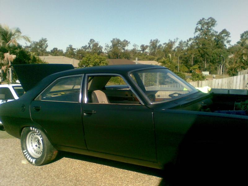

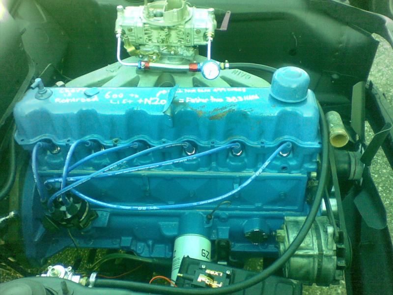

not the prettyest car eva built but lightest we have .
my mates 1974 chrysler centura 265 hemi 6 cylinder 4.3 liter drag car will have 125 shot of nos as well .
