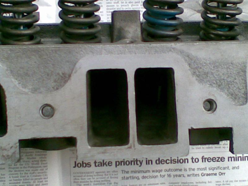

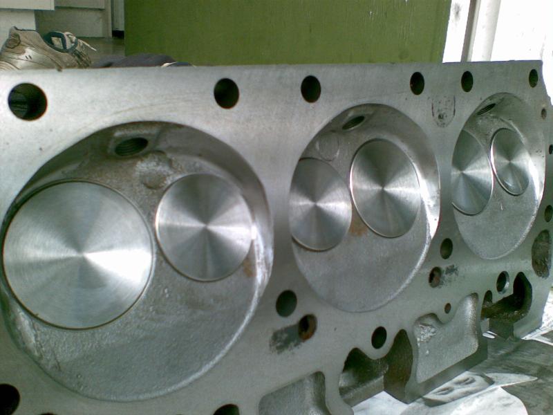

Old Jul 10, 2009 | 10:55 PM
  #83
deadkelly's Avatar
Joined: Oct 2007
Posts: 1,127
From: queensland Australia
i got my heads back .
here's some finished pics
Attached Thumbnails g'day all i pulled my 383 down & found .-11072009.jpg   g'day all i pulled my 383 down & found .-11072009-013-.jpg   g'day all i pulled my 383 down & found .-11072009-015-.jpg   g'day all i pulled my 383 down & found .-11072009-002-.jpg   g'day all i pulled my 383 down & found .-11072009-010-.jpg

the springs were a lot heaver than we thought . there around 150 lbs / 350lbs there only singles with dampers . could they be the mopar battleship springs ? that's what may have bent the stock pushrod + over revving . i'm taking the block down on monday to get sonic tested .
Old Jul 11, 2009 | 03:23 AM
  #85
Polaradude's Avatar
Joined: Dec 2008
Posts: 2,509
From: East Coast Canada
Ya won't have to worry about valve float..
Heads look good man.
Old Jul 11, 2009 | 05:04 AM
  #86
HemiSilva's Avatar
Member
Joined: May 2009
Posts: 89
From: Annandale, Va
Lookin good DK, thanks for the pics...
