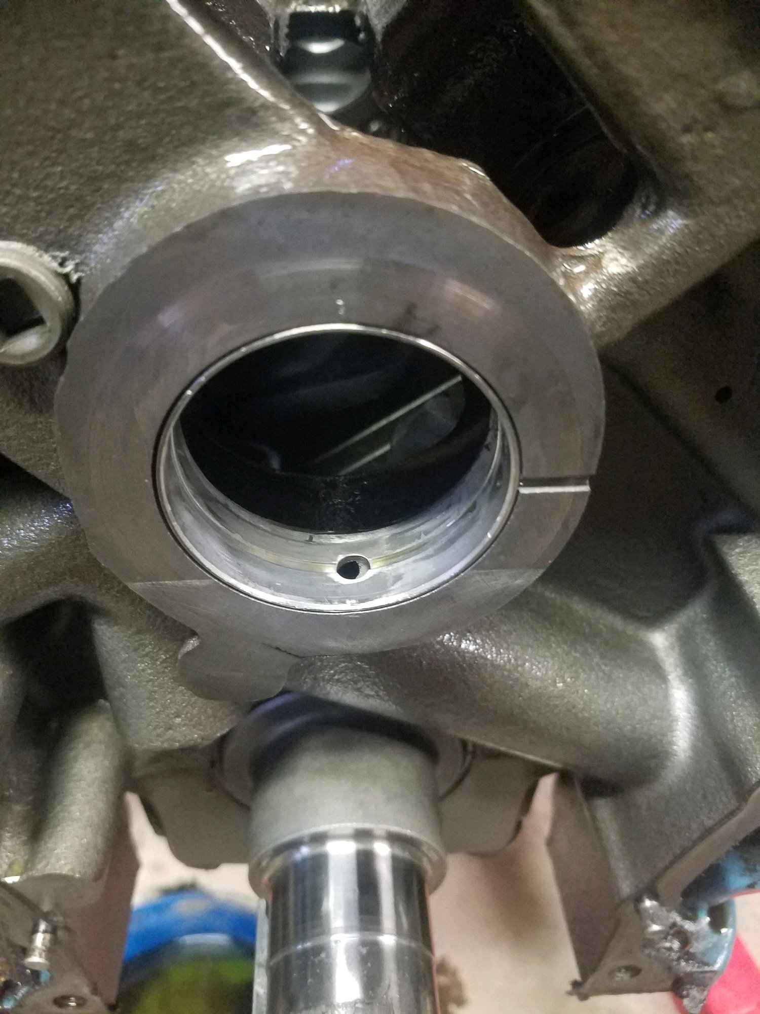

First two bearings were like this.

It is a possibility to suck the pan dry... you should be Using the 3/8" pick up with at least a 7 Quart Pan??. But you would have to look at all the bearings for signs of oil starvation... No other damage or alignment issues with Cam or Main Bearings?
That Cam Bearing is not happy at all. I would look for more of those types of issues..

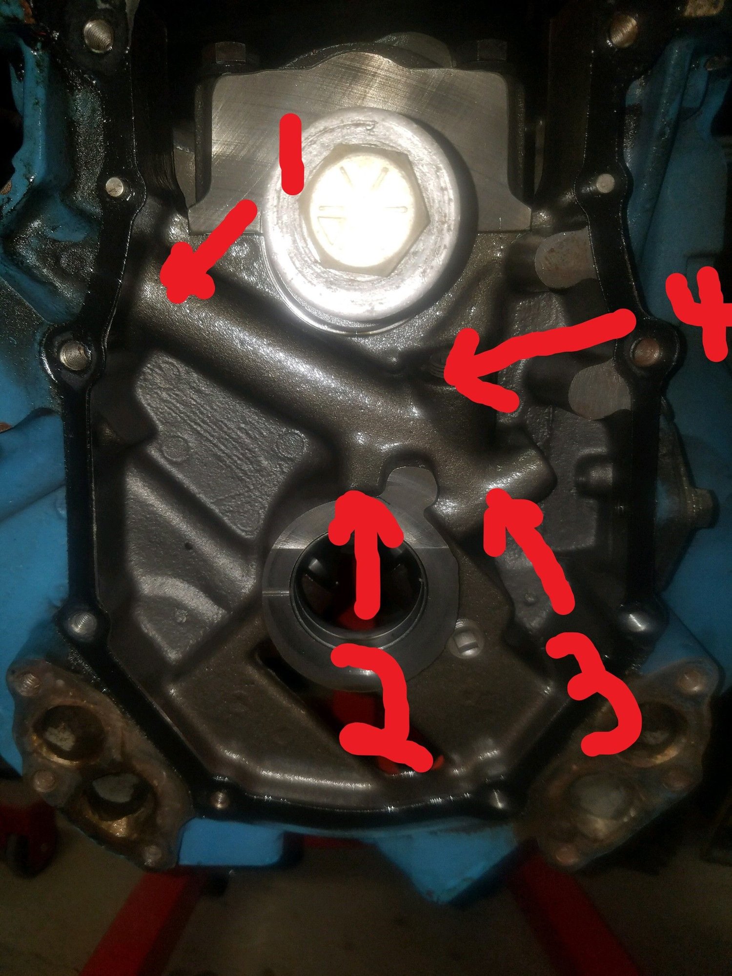

So number 1 is from the oil filter, number 2 is feeding the bearing, number 3 is where the piston for the fuel pump goes and 4 is the galley plug. It sure looks to me not having a piston in there would let the oil go right back to the pan, correct? That passage is open.

I would pull the oilpump apart, just two bolts once it's of the motor. Check for galing then pull the cap off the relief valve and look for debris.....
Old May 2, 2020 | 10:15 AM
Look in the bore and see if it has a hole for oiling? But I dont recall the Fuel Pump Oil Push Rod being pressure oiled !
* as far as I know, the pump rod is cut down on the end that rides on the essictric and the rod is lubed from what if sling off the lifter and dist. drive gear, more of a drip style.*

I pulled the pistons today. The bearings didn't look good but 5 & 6 were bad. Not enough to mess up the crank, that is not blue, good. I didn't pull the crank, I think I'm going to take it to the shop and let them set it up. I recently moved and all my stuff is still in boxes. Gotta put the car on the road. I pulled the pump apart, clean enough to eat off of. I put a light through the oil port going to the cam bearing. I can see light in the cam bearing feed but not through the piston hole for the fuel pump. I think you are correct that it is its own entity and not fed by the pump. The more I think about it maybe I did run the sump dry. Sucks, but hindsight is 20/20. I can't think of any other explanation.
