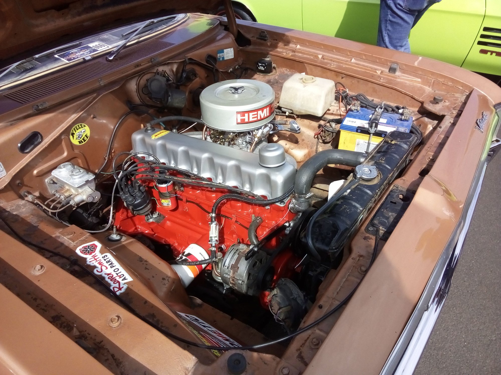

#245

Nice...... Still running point ignition i see ? Is the picture on the dash, a photo of you racing this car?

I'm old school , points n carby all the way .. I've driven it but racing is up to the pirate
