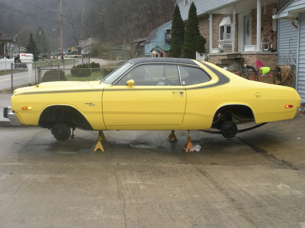

i have a 73 dodge dart sport and i just bought a set of 15x8 american racing outlaw rims for it.. i am trying to find the right size tires to put on the rims.. i dont want them to rub.. please any help would be great.. i just dont want to buy 4 tires and they not work.. the dart is stock, never modified..

call your local tire dealer they should have the info you need. A stock sport can go up a few sizes but nothing to big without doing a tub or mini tub

well you have a sport model so there is a lot of room in the back. I'm sure you could fit 255 60 15 in the back. Up front, 215 60 15. on the appropriate rims.
I had a 71 duster (basically the same car) and in the back I had a set of the old
L-60,15. (Similar to 275 60 15) they did rub but just barely. up front I had a set of 14 wheels with205 75 14 (for the big and little look)
