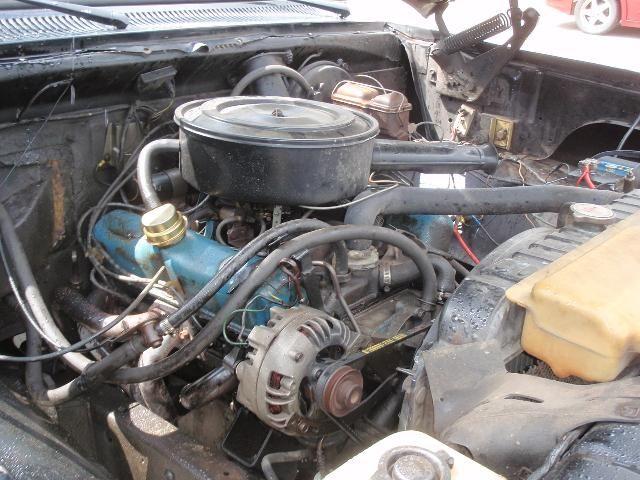

Hello
I recently acquired a stock air cleaner off eBay that will properly fit the Holley 2245 on my truck.
However, I'm having trouble getting a filter element for it and it didn't come with one. I tried searching by my application and the vehicle the seller said cleaner was off of (78 Warlock). Both crossed over to a Wix 42049 which seemed to be too tall for the lid to close.
Looking at the attached picture of a truck 360. The air cleaner is different. The lid appears to have taller stamped bosses (I hope I don't have wrong lid) and the snorkel is longer and on the driver side and my is shorter and on the passenger side.
The cleaner still had a sticker on it with the part number "38300 49". I couldn't find that exact number, but I did find a partial match (of the first 5 digits) using the MyMopar.com part number search.
So, that makes me believe it is a Chrysler air cleaner but, for a different model and/or year. Maybe it's off a 360 that was in car or a truck with smog? It fits the airhorn of my carb perfect.
So, does anyone here know the application for this cleaner or a good part number for the correct filter element?

Old Nov 2, 2017 | 01:58 PM
That's the rite Wix number......
The Fram # CA347....
But that should be the rite filter... Maybe the wrong air cleaner asm....?

Well, I got in touch with the ebay seller I purchased the air cleaner from and it looks like they sent me the wrong lid for it. They said they'll have the correct one shipped out tomorrow. So, hopefully that will fix my problem and allow the filter to work.
I still find it interesting that the snorkel is different.
