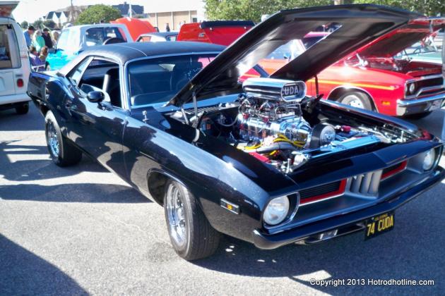

I am switching out My bosch plugs I researched and purchased NGK XR5IX they are pre gap at 0.35 I run a 8.71 blowin 440 @ 9.5-1 compression, full MSD ignition including wires I would like to leave the 0.35 gap but have seen a few who have increased it to 0.40 or larger opinions please if your running a high performance big block. I produce over 700 hp and it runs great but its time for a plug change.
