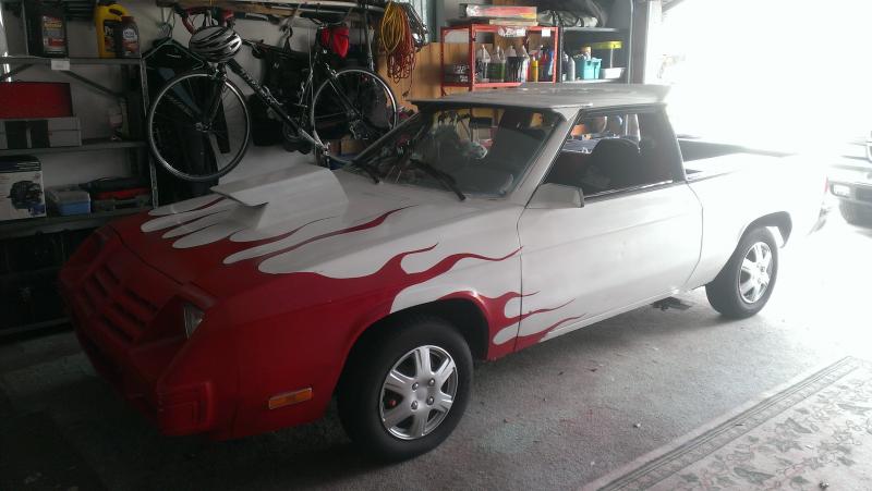

By the way thats what were working on O.o
