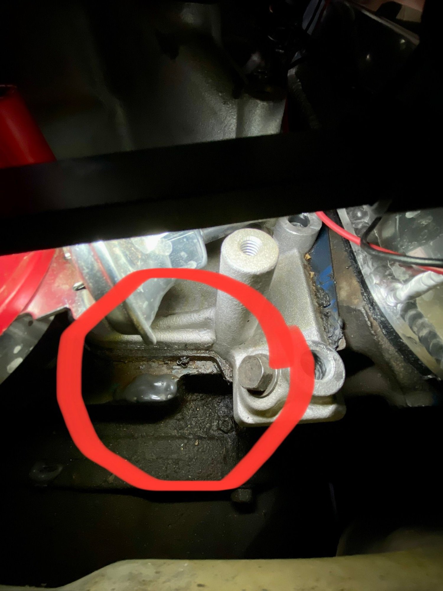

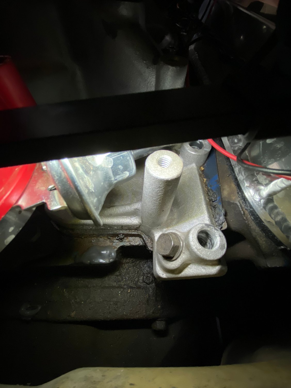

I didnt no where else to put this post so i just stuck it here. So, I acquired this 1976 D200 with a 360 in it. The previous owner put on the folowing adds. A midrise intake manifold, an off brand AVS 1406 carb. and a (what looks like) GM HEI distributor. The oil gage on the dash was not working. Went to go check the oil sending unit and no hole. So, I'm asking all of you how to get rid of the JB Weld (or what ever is in there) or can sombody tell me if there is another place to hook up a sending unit for the oil.

I cant tell from the pic but there should be another plug next to it. My 383 has two plugs both going to the camshaft. .

Yes you are correct. I believe that all the big blocks have 2 holes and the small blacks have 1. I have never seen this done. Why?????

Not really another better place.... My suggestion..... Remove the J.B. Weld.... Clear out the oil sender hole.... The hole is a 1/8"NPT....
What i do in these cases, is install a 45* brass or steel fitting with a longer nipple and a connector for the sending unit and put it back near the firewall near the valve cover.
Hope that makes sense?

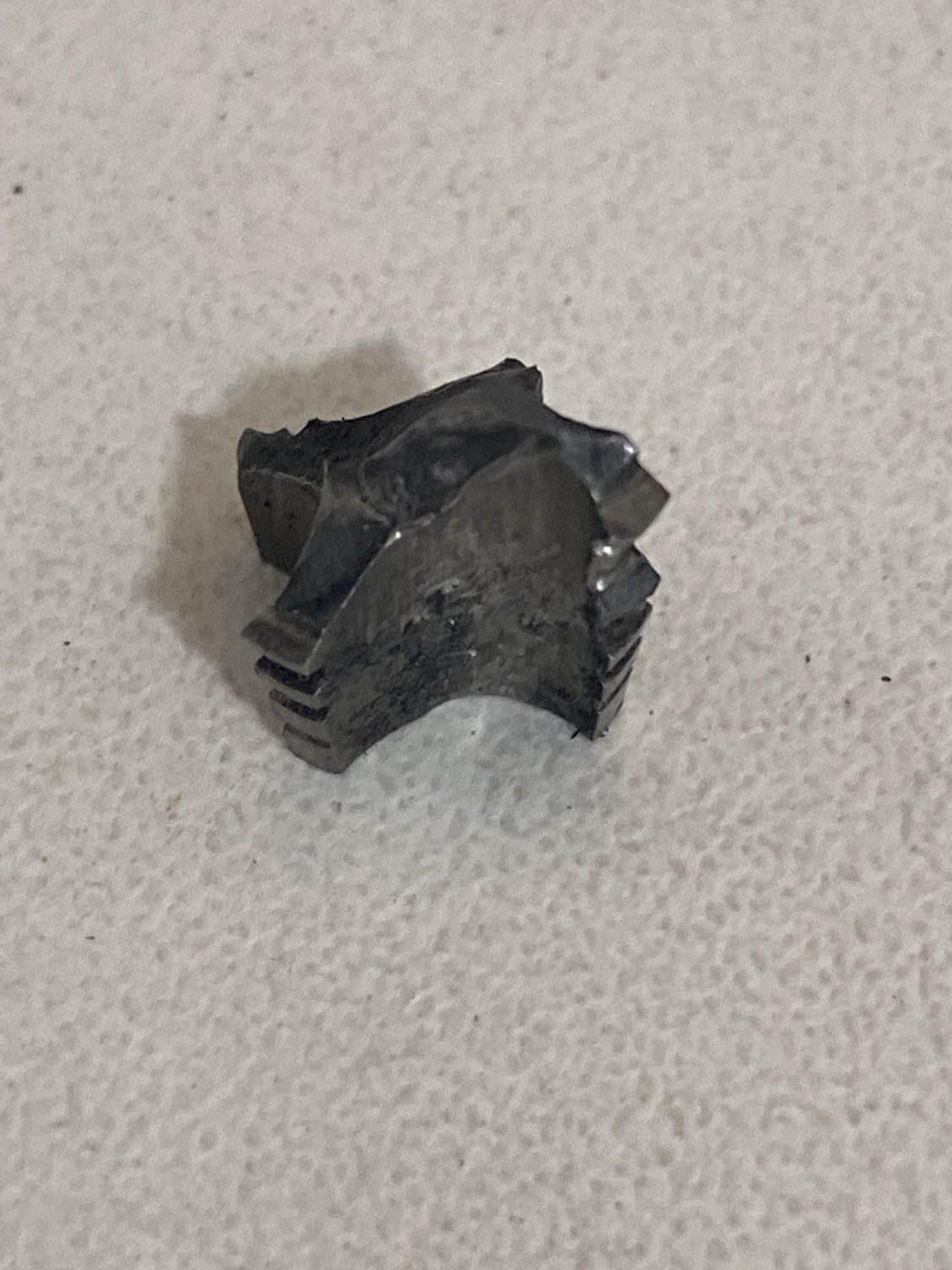

hey cowboy thanks for the NPT size will save me alot of time. took off the JB Weld and found a broken tap inside the hole. Thinking that they broke off the sending unit and then tryed to drill out the remains, screwed up the hole ,tryed to retap than broke off the tap and didnt want to deal with it and filled it with jb weld.Going to go clean it out the best I can and figure out the next step

Well, Depending on how the threads look when you get it all cleared out???? and how thin the outer wall becomes? Looks like you mite have 3 choices, Depending!!
1- Heli-A-Coil
2- Time Cert
3- Some type of Nut Cert.... lol >>>>> OK, Weld it up and remachine it.... Cheers
