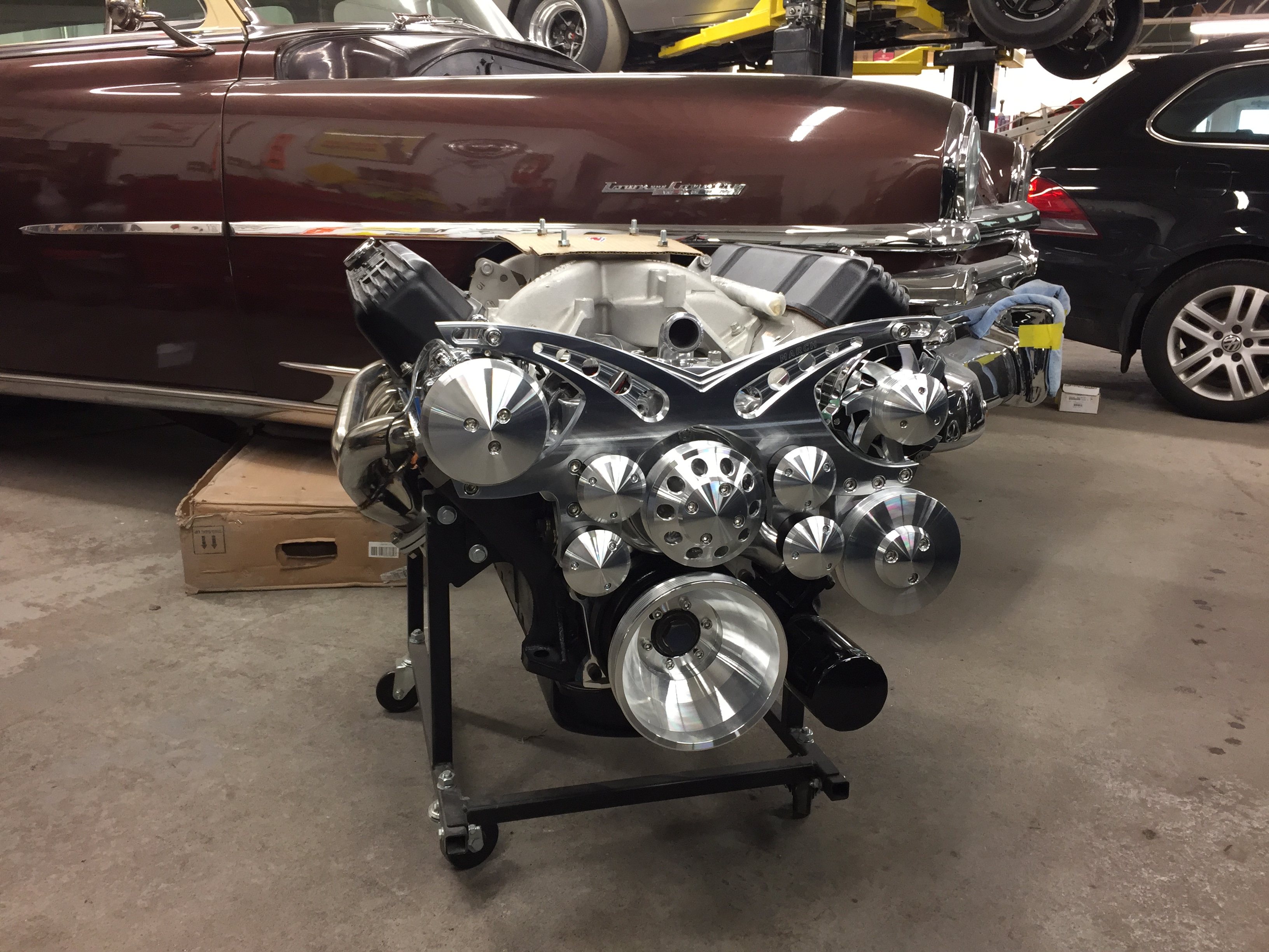

From: Michigan
March
Just installed the March in my 440/53 Chrysler Wagon. Installation was straight forward and the quality of this system is first class. The kit I bought included the water pump, AC, power steering, and alternator.
Pricy but worth it in the end.

Old Feb 1, 2017 | 07:08 PM
Those work great...

Old Feb 4, 2017 | 01:05 AM
You will notice the compressor is different and will not be in the stock location so the intake shouldn't matter... You will need a R134 retro kit for the air..
