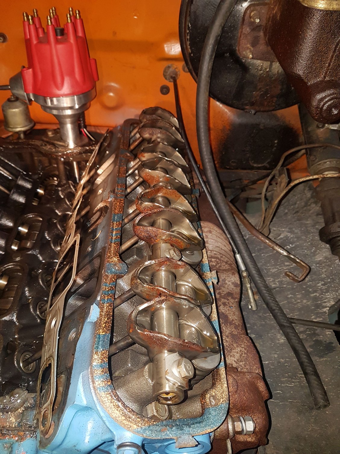

Anyway, thought I would share pictures and ask for some opinions. I see a lot of rust on the rockers, I assume from condensation and/or the water from getting on it and the truck sitting for so long.

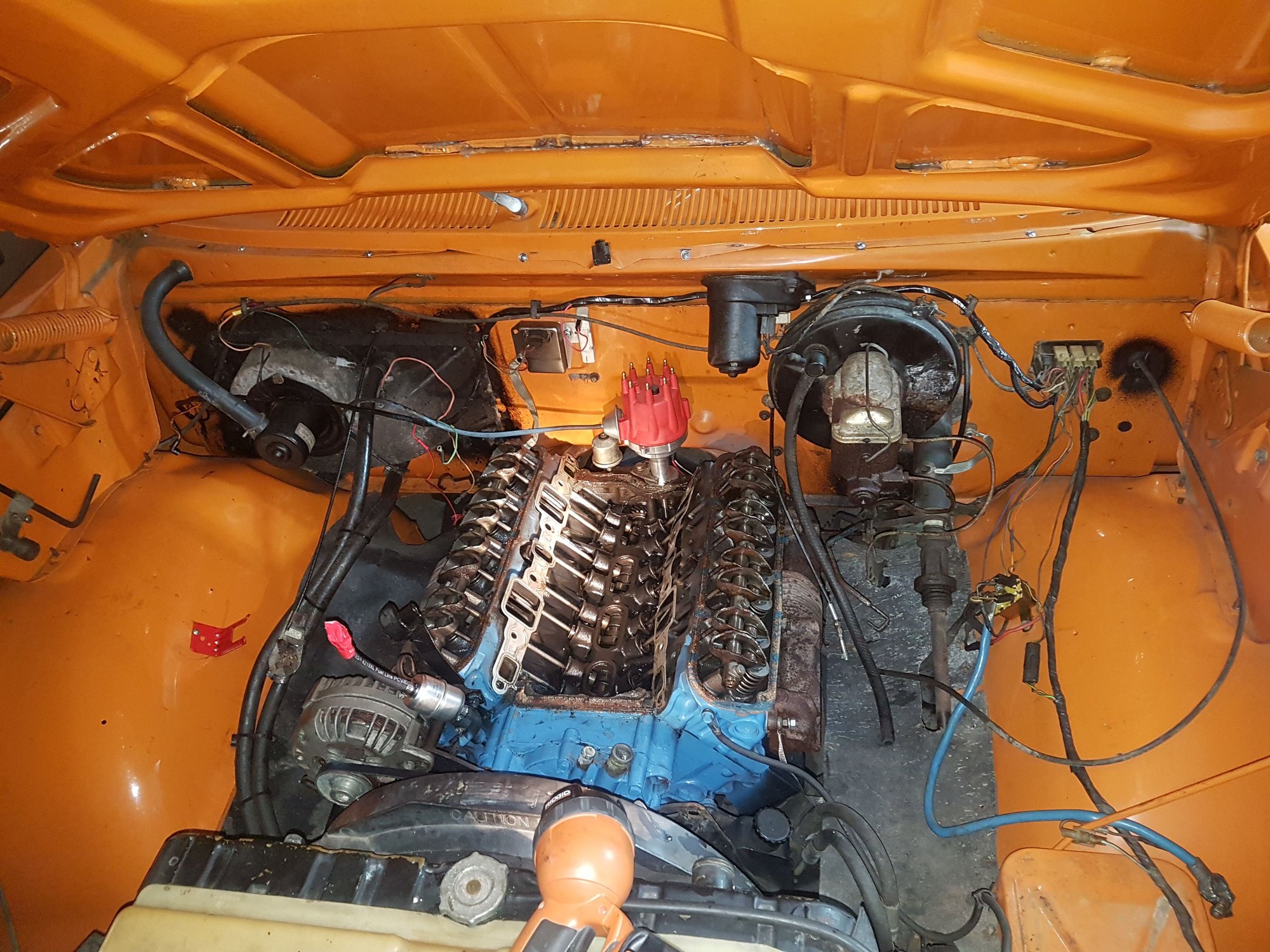

Took the intake off the engine in the truck tonight

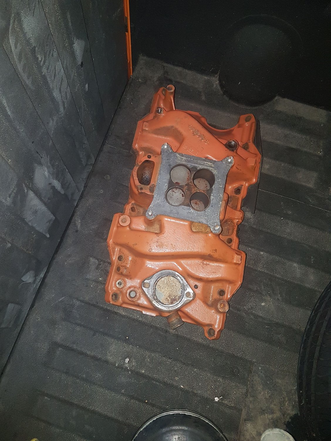

The intake and 2-barrel carb from the current engine
RUST on the rockers - looks like I will need to do more than I wanted

It looks to me as if the lifters are only touching on side of the cam shaft?
