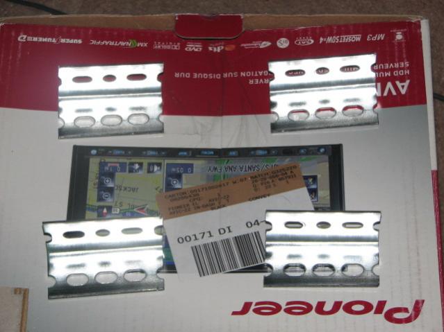

I also made the brackets for the front seat front moutns...
Attached Thumbnails 1970 FY4 Gold Plumouth /6 Duster-clean-400.jpg   1970 FY4 Gold Plumouth /6 Duster-img_0045.jpg   1970 FY4 Gold Plumouth /6 Duster-bb-727.jpg   1970 FY4 Gold Plumouth /6 Duster-452-heads.jpg   1970 FY4 Gold Plumouth /6 Duster-seat-brackets.jpg

Forgive me if I'm telling you something you already know, but you are going use an original seat anchor point, or weld in a reinforcement for the seat anchor. Right? Just want you to be safe.
Yeah, I'm getting some reinforcement welded on the new floor pans. I saw somewhere that welding four 3X3, or 4X4 steel plates to reinforce the attaching points should be exactly what is needed. So, I'm going to set the seats where they will be mounted, mark it off, weld in the plates, and drill through that. The bracket will bolt to the floor, and to the seat bracket. The rear bracket will bolt through the supported floor pan.
