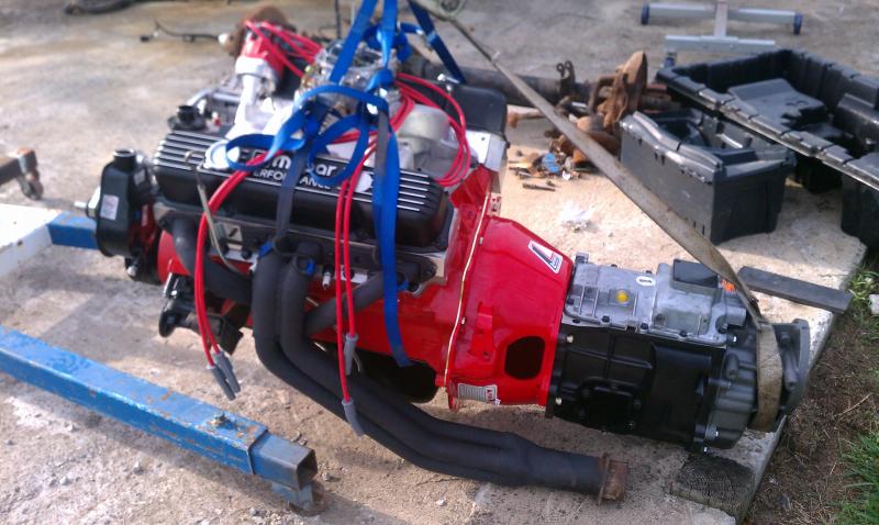

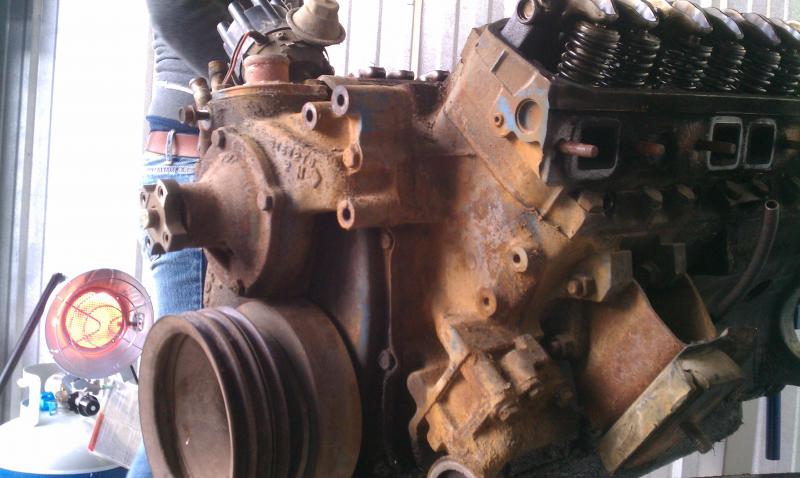

Alright i am in the Air force and im stationed at whiteman AFB. I have a 1999 Dodge Dakota 4x4, I blew up the original engine (5.2L) about 2 years ago. Since iv had the truck iv wanted a bigger engine in it with bigger tires, so i took it as an opportunity to build my dream truck. So i sold my dirtbike and picked up a 1974 440 out of some motor home, then begin the project. I took it apart and sent it to the machine shop ect. ect. (This is getting to be a longer post than what i thought) Anyway heads where cracked so i went to edelbrock and got the PERFORMER RPM PACKAGE, to the point its got kieth black flat top pistons 10:1 compression, oh and its bored .30 over. it has an edelbrock performer 750 carb. I am working on building motor mounts to make it fit.
Now for the rest of the truck i got a 1999 dodge diesel nv4500 5 speed tranny,getting a dana 300 t-case, i plan on getting dana 60 8lug front and rear axles for it. Also i want to do a 4 link suspension with coil over shocks all the way around. Im sure im forgetting something. Anyway thats what i can think of right now.
Any comments, question, or tips appreciated.

GREAT COMBO! 440RB with an NV4500! Which version of the NV4500 did you get?
Depending on the HP and torque from the motor, it may be a bit much for the D300. I'd save up for an Atlas or a Stak as a replacement though. Are you keeping it passenger side drop or flipping it to the driver's side? If you leave it passenger side, any GMD60 will work. If you go with a Dodge, make sure that it has the internal style hubs. There is a larger aftermarket support for it. If you decide to flip the D300 (go with a cable shift kit from NWF - VERY nice), you'll want to get a pre 91 or 92 (I believe) as the later ones have ball joints. The earlier ones are all kingpin, plus you'll have a high pinion which will be driving on the stronger side of the ring gear.
For the rear look into getting a Corp 14B out of a 1 ton. The 14B has the pinion support and the drop in pinion (both are nice). plus the 1 ton version has thicker tubes than the 3/4 ton version.
It looks like a great build though. I can't wait to see more.
