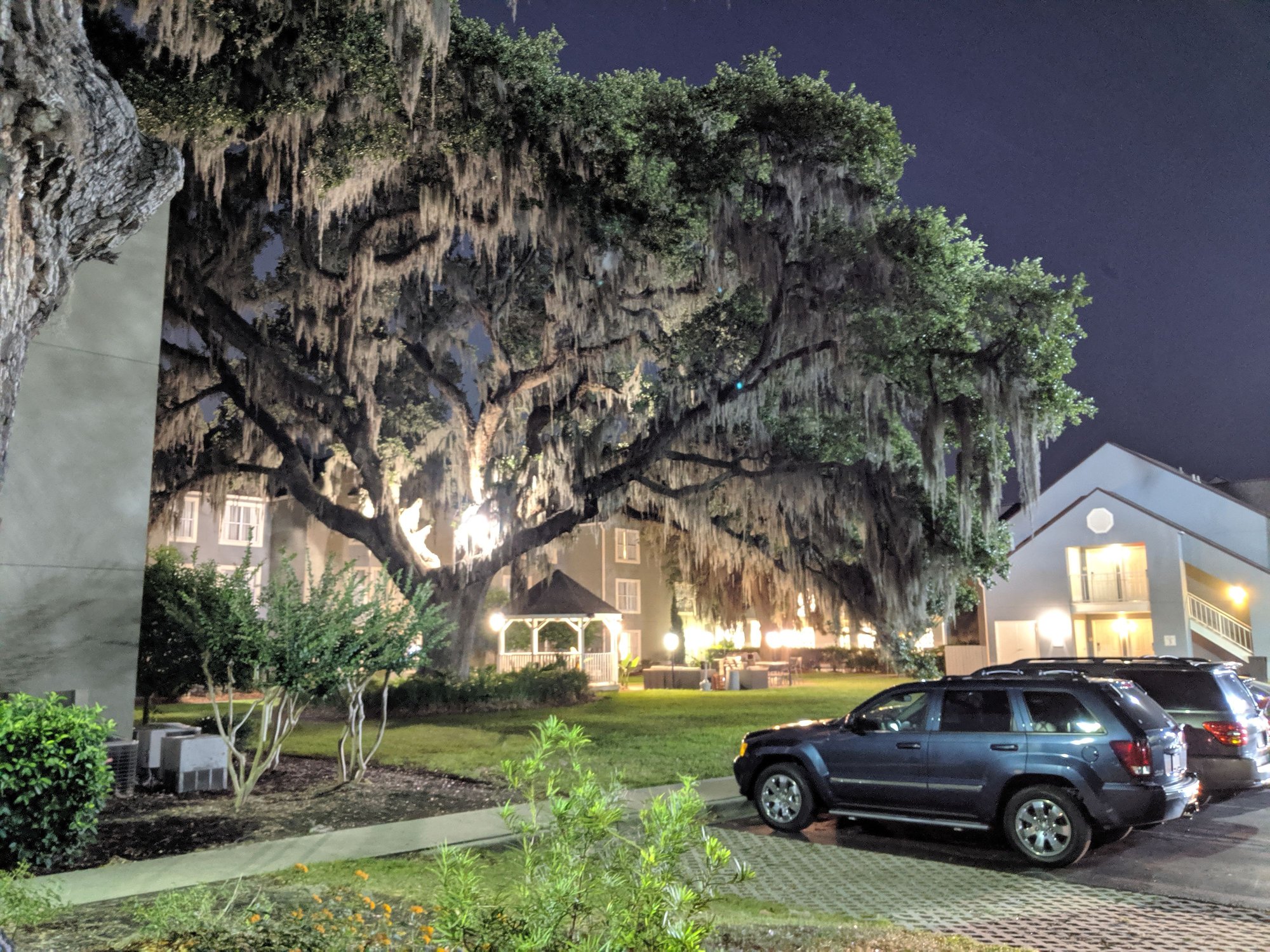

Definitely happy with how The Cookie Monster is driving these days. This road trip for work today made up my mind to keep things as they are.
I drove with the AC off (can't do that with lady Wreklus on board) and really paid attention to how it dove, handled and sounded.
Ended up getting an average of 18mpg, which is pretty good considering the thirsty tune. The sound of the go-happy fuel injectors, smooth valve train and the strong (but not insane) exhaust was really satisfying.
Being in Savannah, I had a lot of other tuned up cars sounding off with revs and a lot of turned heads when I cruised by groups. It's very different from the kinds of people we have in South Carolina. It was nice to get some positive attention for a change.
Anyway, got a good view from the parking lot. I don't think The Cookie Monster will mind being parked by the old oak trees tonight.

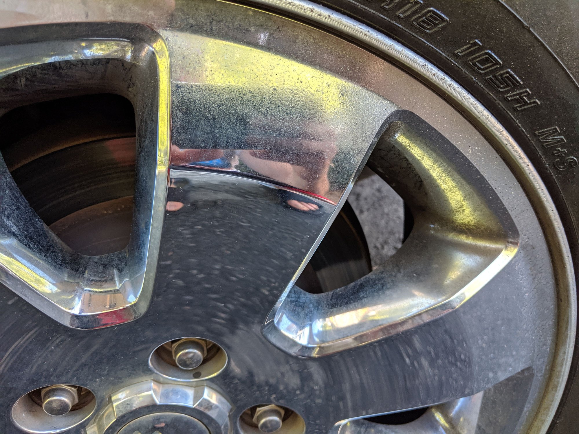

Since my knees and back are already sore, I'll pause to post some pics of the process for cleaning chrome wheels!
Before cleaning. There is a combination of tiny rust dots, road grime, brake dust, and some over spray from tire shine. Not the worst way to start, but definitely not show worthy!
Slathered up! I use Turtle Chrome Polish and Rust Remover. I like Turtle because their chemicals are as tough as you can get. But, they are also potentially disastrous if you spill or over spray on the wrong surface. I used a super cheap microfiber buff pad and applied by hand. I never use power tools when detailing. Too easy to over do it.
Let it dry for several minutes into a haze. This is a good opportunity to pace yourself and crack open a "soda", or just give your knees a break. ((I need to get a low stool to sit on for stuff like this!))
Wipe the chrome down with a paper towel. I really like the blue shop towels you can get for cheap at Walmart for stuff like this. Don't be afraid to give it a LOT of elbow grease. Chrome is a very hard metal, so it won't scratch within the limits of human ability. If you use a buff tool for this, pick a thick, soft pad and remember that more time is better than more force.
I'm definitely not a professional, but I have done a lot of detailing on my own cars. If you want to share tips, or ask questions, feel free to jump in on this thread. But, if you're going to want to have a conversation over several posts, please make a separate thread for your own vehicle and ask there.

Very Nice!
Me like shiny.
Old Jun 21, 2019 | 05:54 PM
  #139
Looks Good !!!>>>> This was my old go too stuff.... Old Skool....
https://simichrome.factoryoutletstor...UaAlXjEALw_wcB
I'll have to give this stuff a try.
I ended up using a ton of elbow grease on the front passenger side and still had to re-do my work on it. Pain in the !!
Glad I got it done though. All that's left is to tire shine, wipe down dust in the engine bay, and sparkle up the trim accents. Easy day tomorrow!
