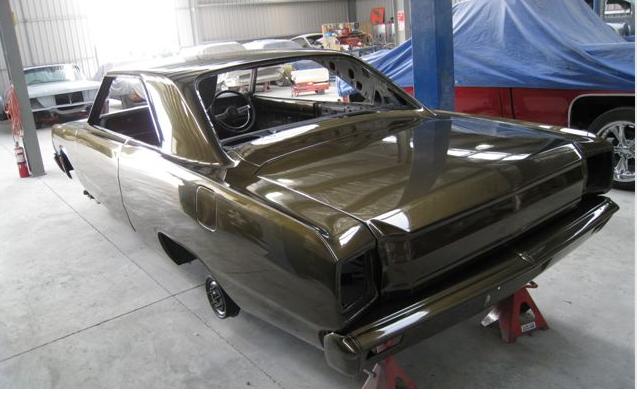

assembled but not buffed up yet!! waiting on a custom alternator bracket for the belt drives up front then dumping the powerhouse in - hopefully next weekend!!!
Attached Thumbnails NZ Dodge Dart (Valiant) -lo res only sorry-right-front.jpg   NZ Dodge Dart (Valiant) -lo res only sorry-left-side.jpg   NZ Dodge Dart (Valiant) -lo res only sorry-left-rear.jpg   NZ Dodge Dart (Valiant) -lo res only sorry-right-rear.jpg

What color is that? it looks great.

believe it or not it's actually a BMW PPG colour!!

Looks nice and straight.....What size motor & box are you dropping in it??

well tickled 318 - 30 thou o/bore, new balanced pistons, shot penned rods, new lifters and push rods (oil journalled). Line honed, crank balanced and polished and oil journals ground. Block hot tanked and head surfaces machined. Heads decked and pocket ported, oversize valves installed and aggressive Holley cam (nearly .50thou lift). Mopar Performance dual plane high rise manifold and new Edelbrock performer series 600cfm carby. Electric ignition, Genie headers and Gilmer belt drives. Shift kitted 904 trans with 2800 RPM hi stall. Hurst Promatic on it's way - just need diff, brakes, driveshaft and interior (it never ends!!)
Car totally shaved and rear bumper flipped and stretched to fit up front.
Indicators welded out and petrol door added. Colour coded bumpers and 20"s on their way
