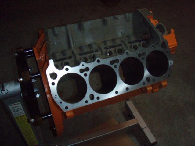

Here is the block fresh from the machine shop. .030 over and clearanced to 4.150 stroke. Had the oil pickup tube hole enlarged to 1/2" also. Gave her a fresh coat of Mopar Orange today. Man I'm gettin excited to put this thing together!!!!
Attached Thumbnails 440 Big Block Build-pb240269.jpg   440 Big Block Build-pb240270.jpg   440 Big Block Build-pb240271.jpg
Old Nov 24, 2009 | 03:25 PM
looking good!
