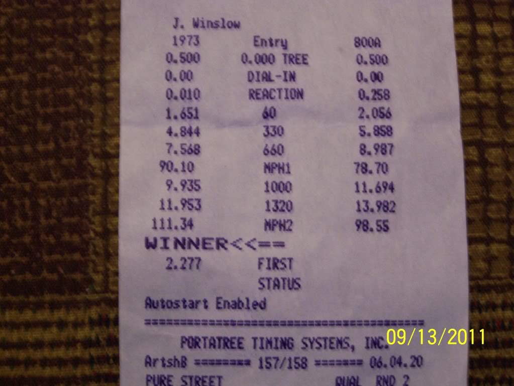

Commando brought up a good point. What heads are you going to use? Why the nitrous? On you first build, I would stay away from it. Your car is much lighter than my cuda,and I have gone 11.95 this year.
Size:  79.1 KB good luck,john
