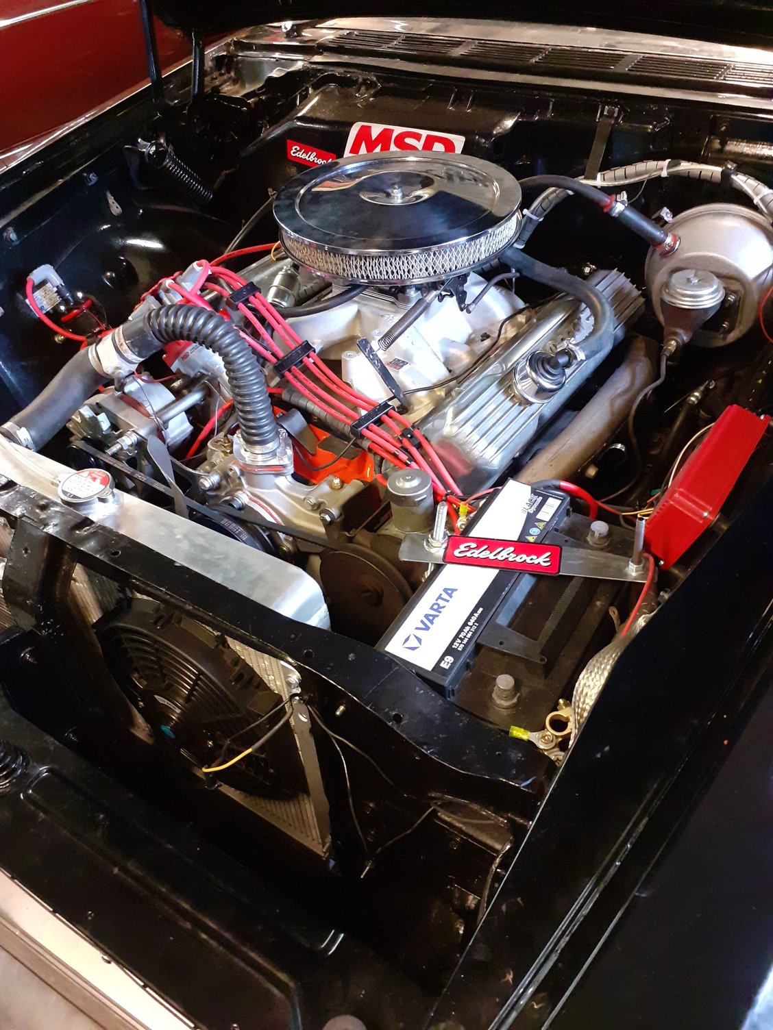

Old Aug 11, 2019 | 12:11 PM
Mopar493's Avatar
Joined: Feb 2019
Posts: 42
Hi! I just want to make an update from Sweden, my 493 cui stroker engine and the car is ready, this engine build be a succes, i break in the camshaft 1 week ago, the engine starts right up and the 20 minute break in at minimum 2000 rpm went really well, i change the oil(Joe gibbs br30) and cut up the oil filter and there was nothing, totally clean and the oil looks great, a little black from the Joe gibbs assembly lube i be very generous with on the cam and bottom of the lifters and also on the pushrod tips and valve tips and oilpump driveshaft gear and fuel pump arm, and little fine silver powder in from piston ring to cylinder wall break in, not any metal parts at all. I change oil to Joe gibbs hr2 10w 30 oil and fired it up again the next day, it runs really good and i have good oil preassure, i use comp cams 922-16 hydraulic lifters with hole in for oil through pushrod and also pushrods with holes through, so i have oil both through the rocker arm shaft from number 4 cam bearing and through the pushrod and still have 25 psi at 900 rpm idle hot engine with 10w 30 oil witch is plenty enough, the oil preassure raise with rpm, at 2000 rpm i have 45 psi hot engine so it all good, i have 0,002" main bearing clearance and the same on rod bearings, the engine runs great and the all the pushrod spins witch is a good sign, the wear pattern on the cam from what i can see through the distributor hole looks good to, i show that in one of the pictures here. I planning to drive it pretty easy for awhile so everything can break in properly, i just couldnt hold my self yesterday and wanted to feel the power a little, so i stopped on an empty road and put in number 2 in the Tci 727 streetfighter in give it about half throttle and the wheels spin loose and leave 2 black stripes on the road about 15 meters, i stoped there but i could have continue how long i wanted, so i see the Eaton true trac works great in my 8 3/4 rear end to. Im really happy my engine build seems to have go so good, the engine really runs like a dream.
