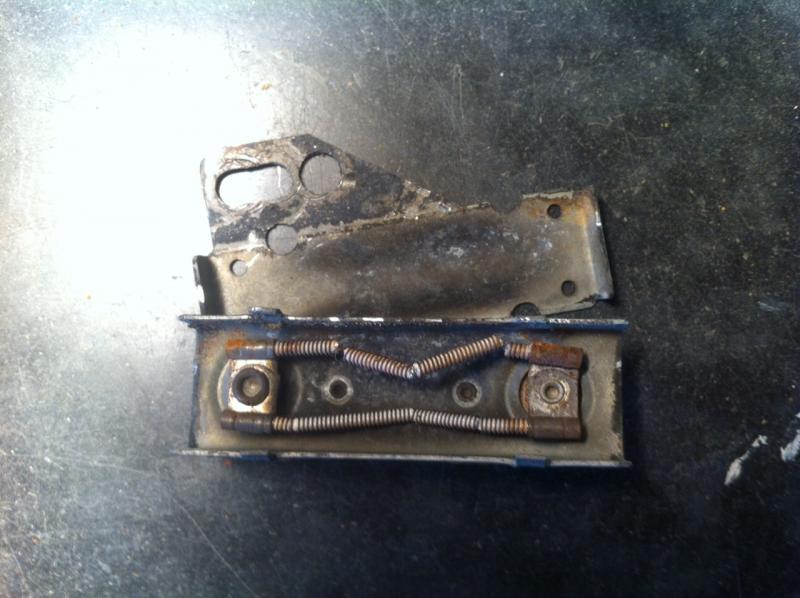

Old Jun 18, 2012 | 04:47 PM
awrdoc's Avatar
It is the ignition switch. Battery has 12.6V, 11.6V with switch in on position and only 8V in the start position to MSD circuit that was added by the guy who made the wiring harness for me.
Removed resistors from ballast resistor and replaced them with copper wire so I can tap off the start and run circuit with the full 12V with a new circuit to MSD box.
Car started just fine with the new circuit but it only gives 9.6V to the box in the start position. This extra was enough for the box to work.
Replacing the ignition switch should give full power.
Thank you all who posted help.
awrdoc
