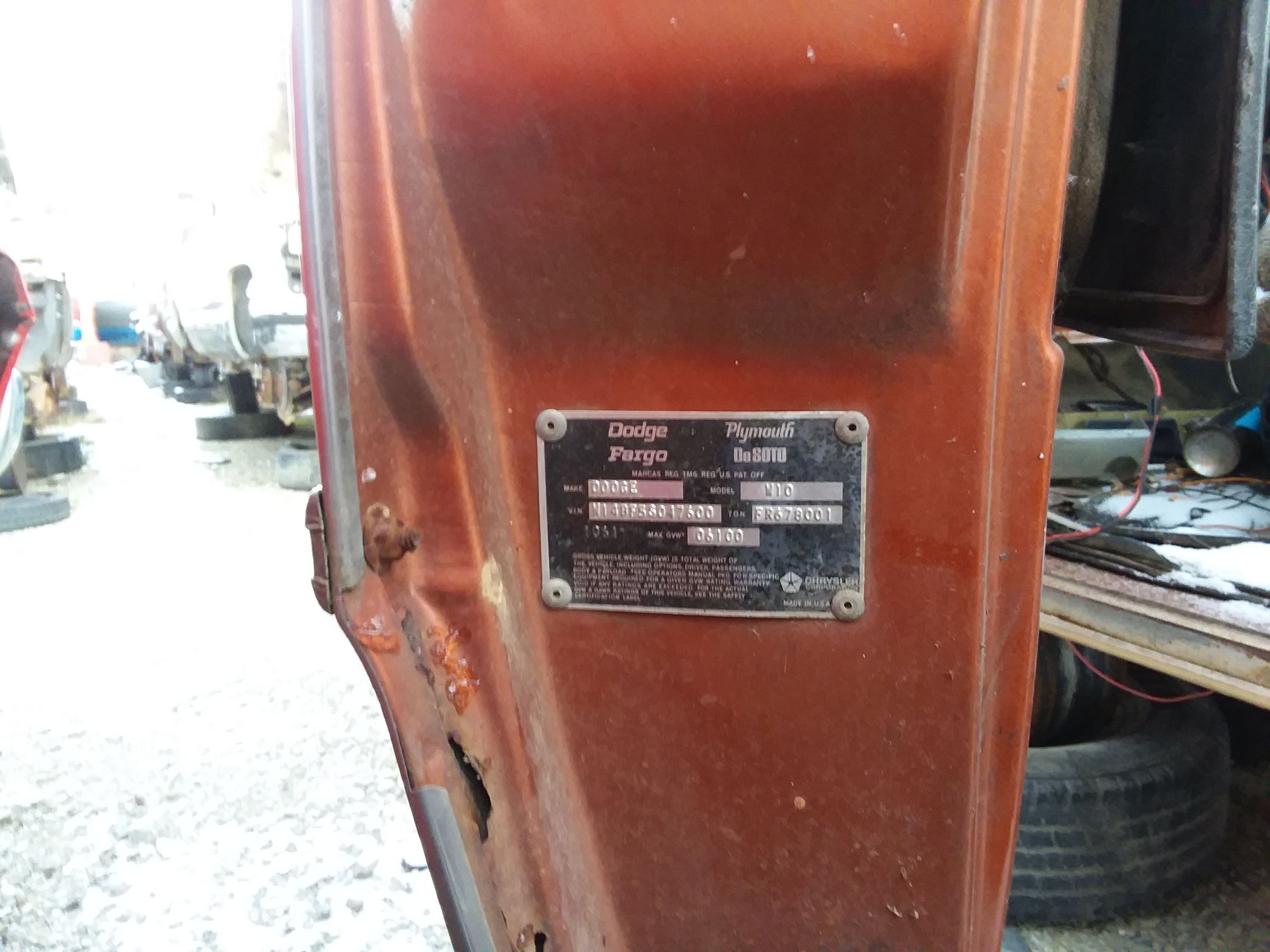

Thanks for the great help on this forum.I am in need of decoding the VIN.I tried web sites and came up empty.I think it reads m14bf56017600.If you see my error please correct me.Thanks.Kurt.

Trying picture again.

Hi! Is there any way you can maybe post a little clearer picture? It's hard to make out some of what it says!

It is my only picture.I took it at the junk yard about 40 miles away.Perhaps you may help me without the vin.Will a 1975 1/2 ton 318ci/727 bolt right up to my 1977 w200 318/727 transfer case?

Okay what I deciphered from that picture is that the VIN is W14BF5S047600 which would make this truck a 1975 Dodge W10 Conventional Cab with Sweptline box. If you would like to know any more information about this vehicle I can help you find some.
