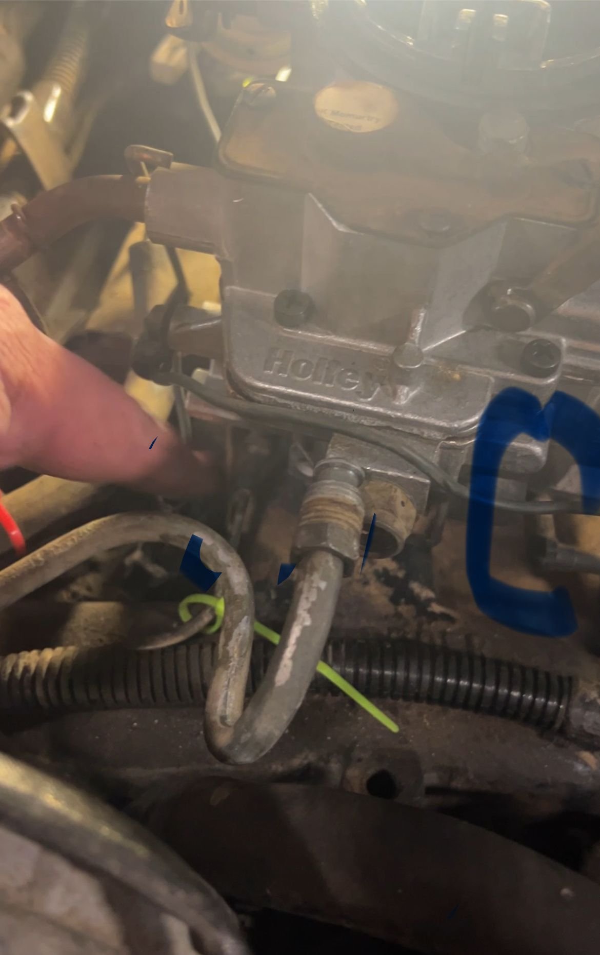

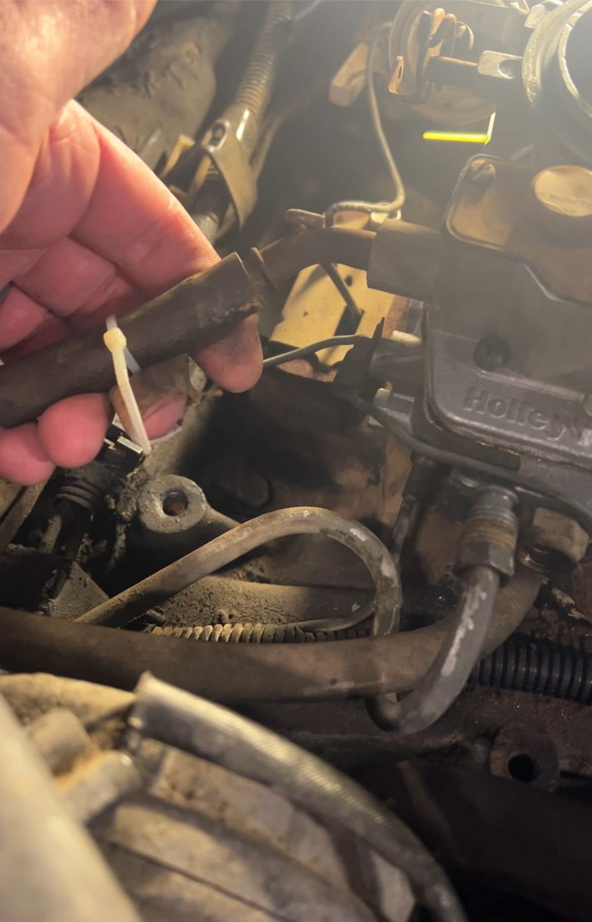

Here is the back of the car showing 2 vacuum lines. The one with the blue dot goes to the PCV valve.
This is a vacuum line on the left side.
Where my finger is pointing and the blue circle shows the two small line attached. There is a larger vacuum line between two.

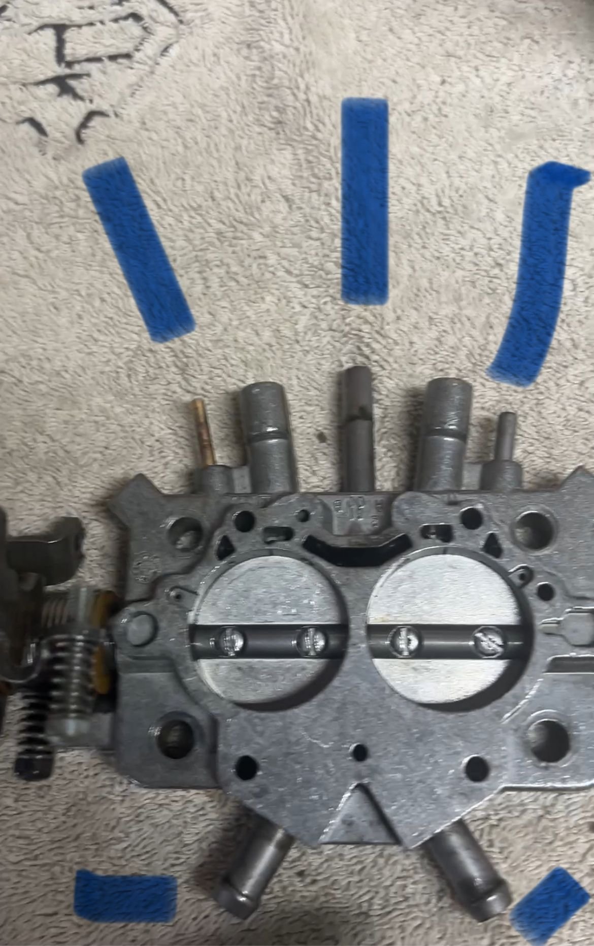

Here is the bottom plate. Showing the back 2 vacuum lines and the 2 small ones up front and the larger one in between.

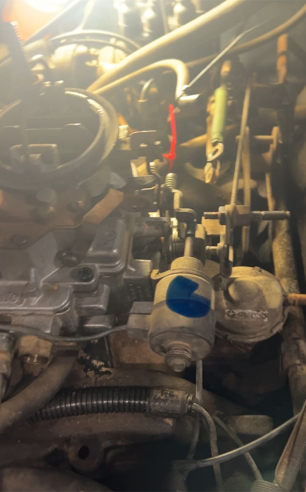

The part with the blue dot has the electrical connection running off the wires.
This is the electrical connection I was talking about.

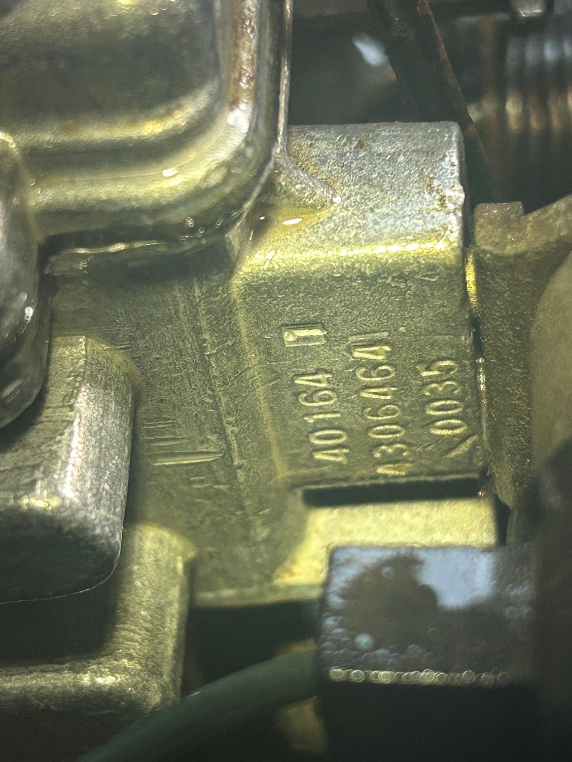

Also here is the Holley carb stamp showing the model number

The electrical lead to the choke is essential on the v8s, not so needed on the 6 cylinders. Without it the choke won't open all the way even though it get heat from the crossover exhaust on the intake manifold. The other electrical solenoid looking device is when the throttle is let off it slowly allows the engine to idle down without backfiring and dieseling. You could try disconnecting it and listen for backfiring. As far as all those lines coming out of the carburetor plate (bottom) those get direct vacuum and usually serve a purpose like going to the evaporator canister.
