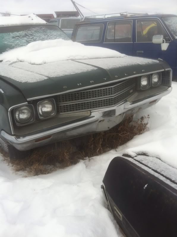

I am new to this site just had a fantastic shape 67 4 door sedan New Yorker originally it had a 440 but was yanked along with the 727 transmission so my grandfather has given me a 318 and 727 tranny out of an 84 diplomat before I start taking the engine and Trans out to be put into my Yorker..... Has anyone done this or heard of putting a small block into this car??? If so what do I need/need to look out for in terms of fuel delivery and engine mounts and that sort of thing. THANKS GUYS!!! Names Kyle by the way and I'm in canada

First it is a 68
Yes it can be done , you will probably need mounts from Schumaker to fit it , the driveshaft will work as is , rad not so much as the lower inlet will be on the wrong side for a small block , shift linkage will work . not a bad swap to do .

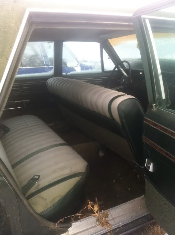

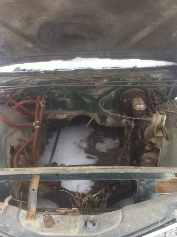

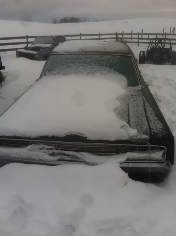

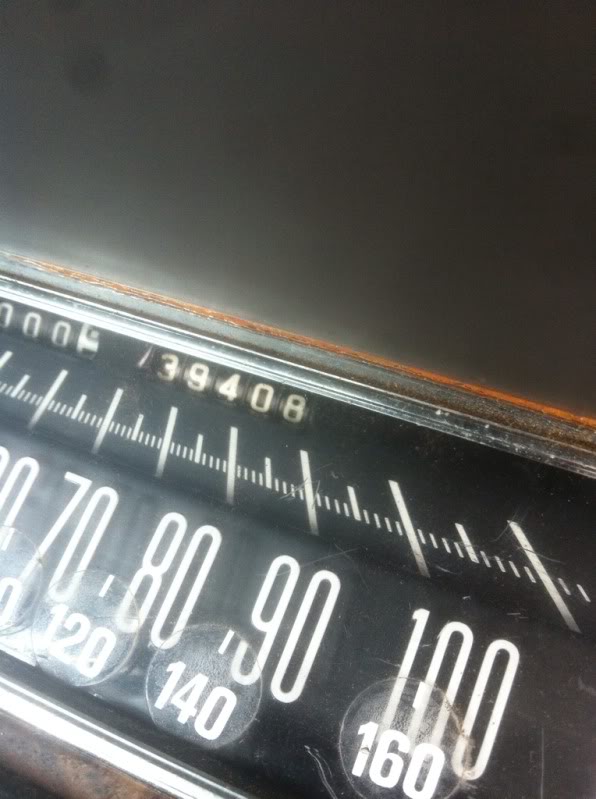

Snapped a few more pics Name:  A179BF8A-ACDD-43CC-B980-8CF9A0E57D33-9654-00000BC0EB6B7534.jpg

Old Jan 28, 2013 | 05:32 PM
Well, yes, not a 'swap' as in there is an engine there already; I just mean going from big to small block. That isn't done very often.

Likes: 43
it is a 68 , it has round side lights , 1 year only , 67 did not have side lights
