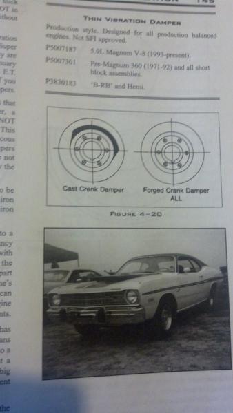

Here you go Bill...
They could not raise the block decks to help with a longer stroke, because the budget did not include altering the automated block and assembly lines to that extent. Weertman and others worked around that, using the same connecting rod as the 318, but reducing the height of the piston from the pin to its top, and cutting the radius of the crankshaft counterweights so there would be room at the bottom of the stroke. While that solved the space issues, the engine was now out of balance, so weights were added to both ends of the crankshaft assembly. That meant redesigning the torque converter flex plate and flywheel, and adding an offset weight to the vibration damper on the front of the crank.
This was the cause of the external balancing.... But Like 440 aid... If you have the rotor asm balanced then you could use all the neutral stuff...
