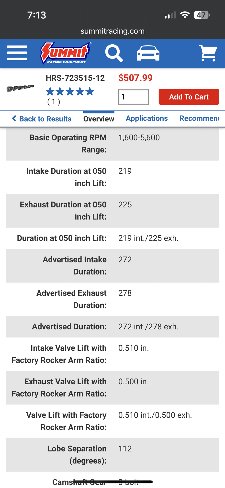

Thanks for the input guys! I think I have chosen a cam.
the Howard’s 723515-12
I know duration at 50 is lower than what I had but I think the overall profile is still a bit better power all around. Hoping it still has a bit of that “muscle car sound”

most of what I do is cruising. I run down the strip once or twice a year and like to do burnouts for my son. Your making me nervous that it’s too conservative…..

That kind of lift and duration should give you some noticeable torque around town. Enjoy!!

Alright I will keep this going in here. After hopefully coming to terms with this cam choice I reached out to TCS in BC to look at getting a converter done and they said that with 3.23 gears my car will basically always be a dog and that the rpm range of that cam is way too low for a 383....... thoughts. Side note, im not going to taller gears. I highway drive too much to be running a 4.10 or something until i win the lotto and do a 6 speed conversion somehow lol
Old Jan 11, 2024 | 04:07 PM
I think I 2400 or 2800 rpm converter will wake up the 383.
I had a similar cam in a Ford 289 project and because of the spline count on the early C4 transmission I didn’t want to buy a new converter for the transmission. Eventually I built a new later transmission and bought a new converter. The stall speed was supposed to be 3200 but the 289 didn’t make enough power to make that happen and stalled in at 2900 rpm. My daughter had been running the car before and after the transmission swap, she went from 14.40 to 14.0X @ a little over 100 mph. She was thrilled and definitely noticed the difference.
that cam will give you a long flat torque curve from around 2000 rpm to 4500 rpm and peak hp about 5500 rpm maybe a little lower. It should be a fun driver.
