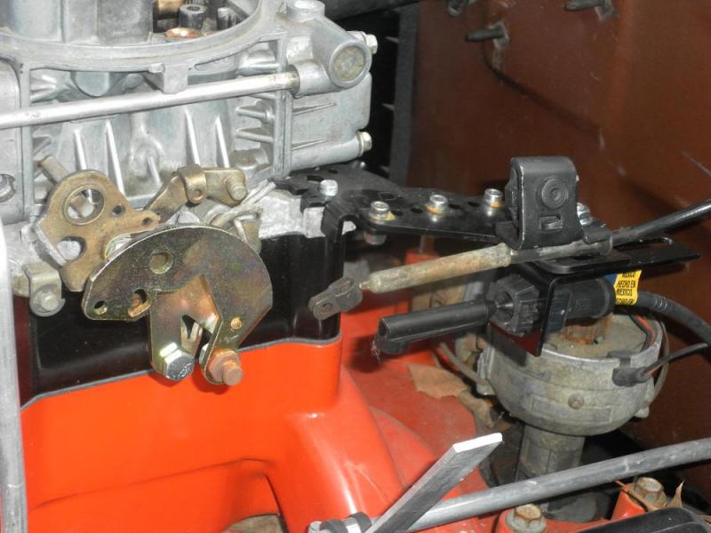

I use a Bouchillion kickdown cable kit & throttle cable bracket
Using this takes away all the guess work & allows use of cruise control & is made by Mopar people & uses mostly Mopar parts & was not originally designed for a Chevy

pw73 -
This is about as clean a set up, as you're going to get (IMHO anyway).
The Lokar bolts on to a carb bolt and is locked in place with screws.
Archer
