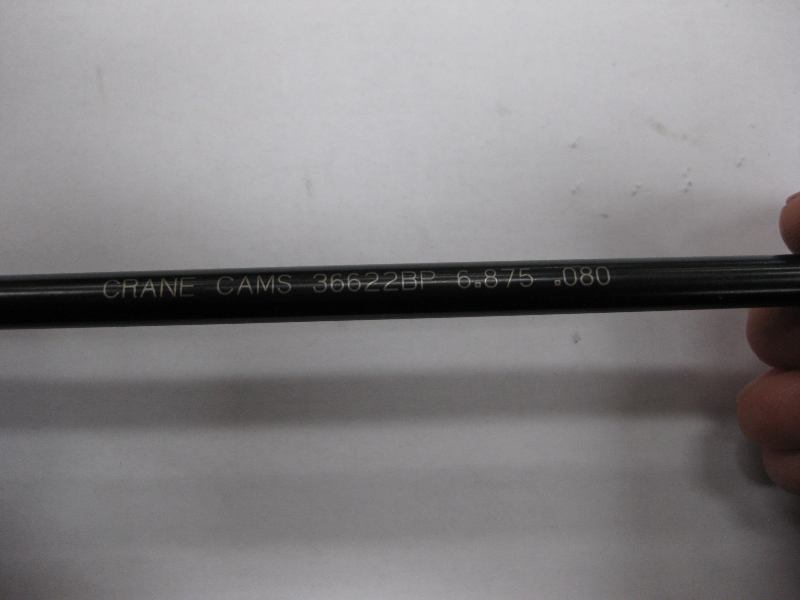

Today I measured the push rods of the crane from 6,875 comps and my digital caliper measurement 6.9155 why?
I have the gauge fault?

now I redid the steps with another digital caliper
push rods original and push rods crane 6.875
something not quite right

I just reread everything and looked up all your part numbers. Everything is good.
If the PR is too long the valves will hang open. If too small they will make noise. So they are not too large.
The stock magnum push rod is 6.920. You measure short but to be honest I do not think she is centered in the tool.
Stand the stock PR up next to the Crane one and measure the difference with the bottom of the caliper. Should be .045
Put the stock ones back in. EOIC to 22 ft lbs on base circle. Run her. If she spits and back fires then too long. If not check to see if you have up and down play in the system by moving the PR up and down when that valve is closed. If she has play then you are still SMALL. Problem solved. Order, install and run.

the difference of the two pushrods is 0.020
