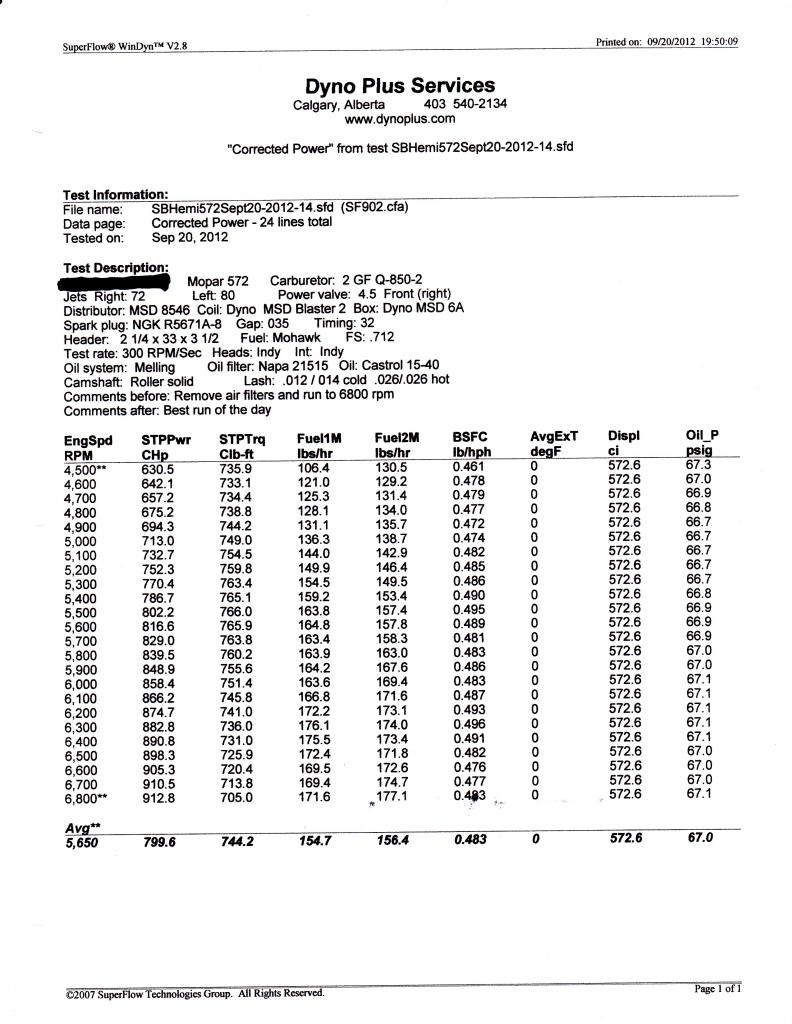

Here is a taste of what I do Daily, for anybody who is "curious" about what I do for a living, seeing as how Neil(Psycho Chryco) seems to think ? or might be isinuating at some level ? that I have to change names for some other reason ?
the 2010 "Mopars at The Strip" in Las Vegas Championship Winning Engine
Anybody want to see the actual Dyno Sheets on the last 2 HEMI Engines I Machined & Built ?(past 6 months)
NSS Nostalgia Mopar SS Wedges ?
Pump Gas Street HEMI @ 912 hp ??
Pump gas 440's, 451's, 472's, 500's ??
Anything you want, I will post up recent builds/combos on ONE condition, NO PHONE Calls at my Shop.
