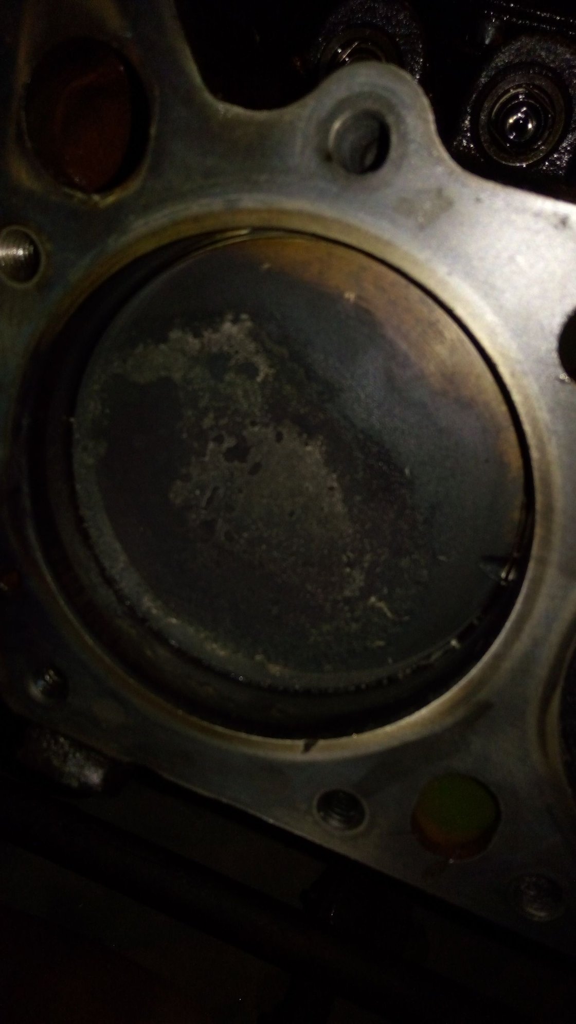

heads will be resurfaced today then pressure tessted then all the valve seals and the frost plugs but im going to post a picture and I would appreciate your guys opinion Might not be able to see it in this one but there is a little chip on the edge of the left rear cylinder just on yhe block here i wanna know if thats going to be aproblem
You can see it here that little chip on the left
Heres a better picture you can see how deep it is
here
Old Oct 31, 2017 | 10:30 AM
What did the gaskets look like?
you should have been able to see the problem in the area of the cylinder in the gasket.
the gaskets were a little rough in a few spots but no damage by that chip. Hoping it'll be fine. I'm going to post a picture of something else. I'm not sure of its name but I know it works with the choke. Anyways it likes to stick down should the bar be bent differently? Here it is
Old Nov 2, 2017 | 02:02 PM
Knock all that carbon off the top of the pistons and blow it all out with your shop air...Hope it's flat and should be good to go back together....
