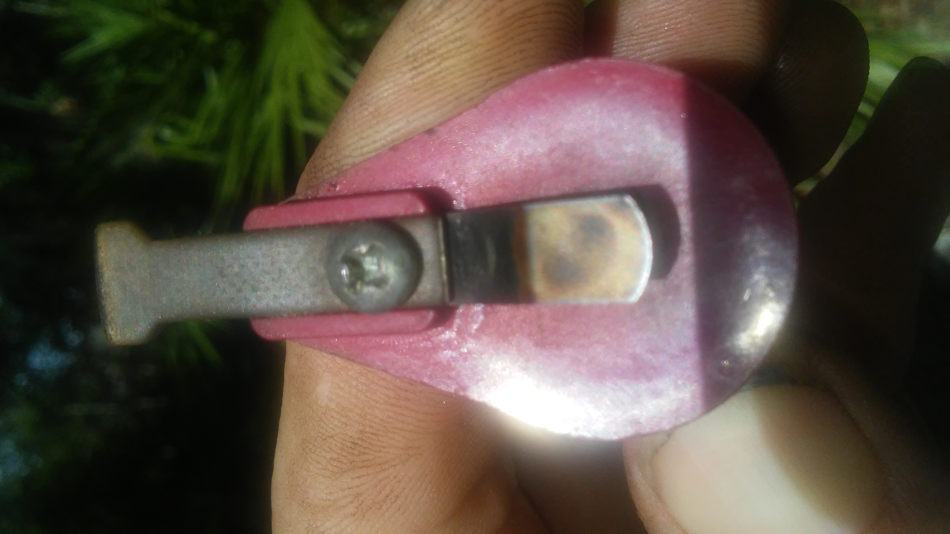

Some pics.
Summit racing has the cap.
I left a comment on the product.
But at $45+ a pop they got to last more than a 1000 miles.
Attached Thumbnails Distributer question.-20170712_164641.jpg   Distributer question.-20170712_164754.jpg

Old Jul 12, 2017 | 08:15 PM
Are they all the 2 peace rotors?
MSD, Malloy, Accel, Holley owns all of it...

Ok, I believe the problem is where the 2 peaces are matted together for the rotor. one of those two side has a coating? (If i recall) and you have to sand it off where it is matted with the other piece.
Or switch to a one peace rotor and see if that fixes it....
just my 2 cents....

Ok i checked it, took it apart sanded the two matting sufaces and reassembled It .
Though i didnt see any obvious coatings will have to wait and see.
The one piece was copper, the other spung chrome steel can't imagine how the two differ in conductivity.
