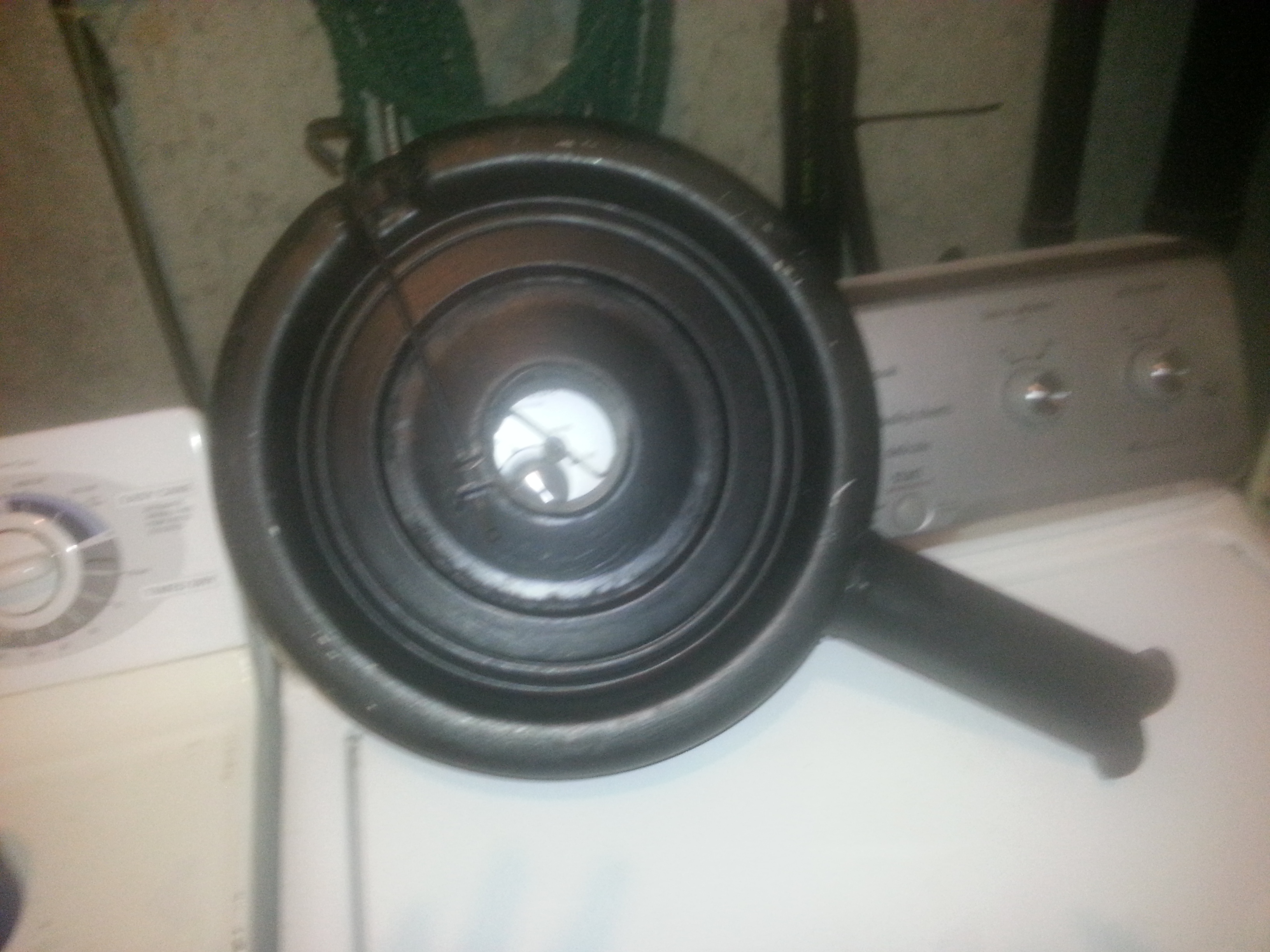

proof i can't decided
air cleaner no opening for tubes.top to bottom.
carb holley i show nothing on a holley for my car.
breather cap no nipple lastly carb has vent tube for nipple to breather cap.
what is the proper carb?or oem style or new plug and play.
is the a california emission car
or is it not i can't tell for sure.

Old May 15, 2017 | 06:54 PM
Air cleaner looks like the rite one for the cars application.....
Oil Breather cap looks like the rite one for the application....
The Carb on the other hand. You are rite. That one is for a later model car or truck the uses the emission charcoal canister.
You are correct in your assumption of the carb that belongs on the car would be a Carter/Ball&Ball....
