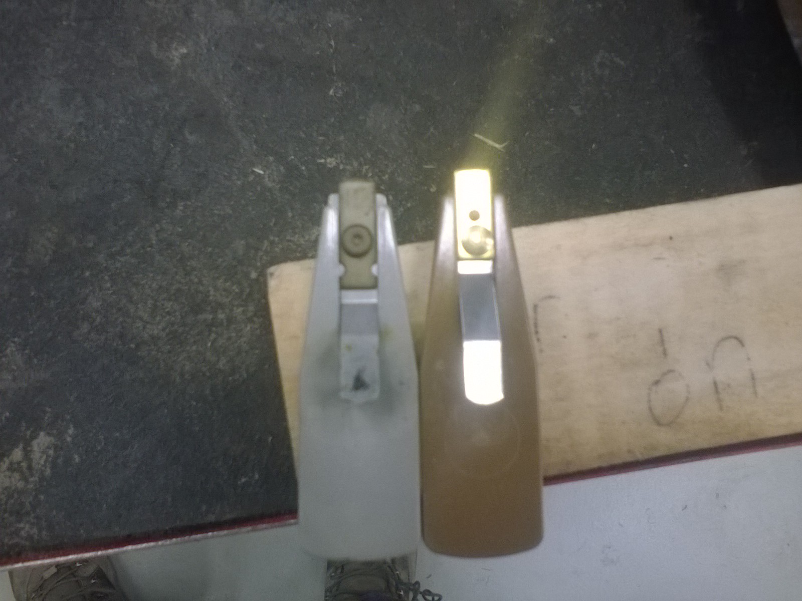

Well, I worked up the courage to install the long tipped rotor. Trucks still runs fine, nothing bad happened, nothing sounds different. So... Success.
Attached Thumbnails distributor cap material and conductivity-wp_20171112_15_49_29_pro.jpg
