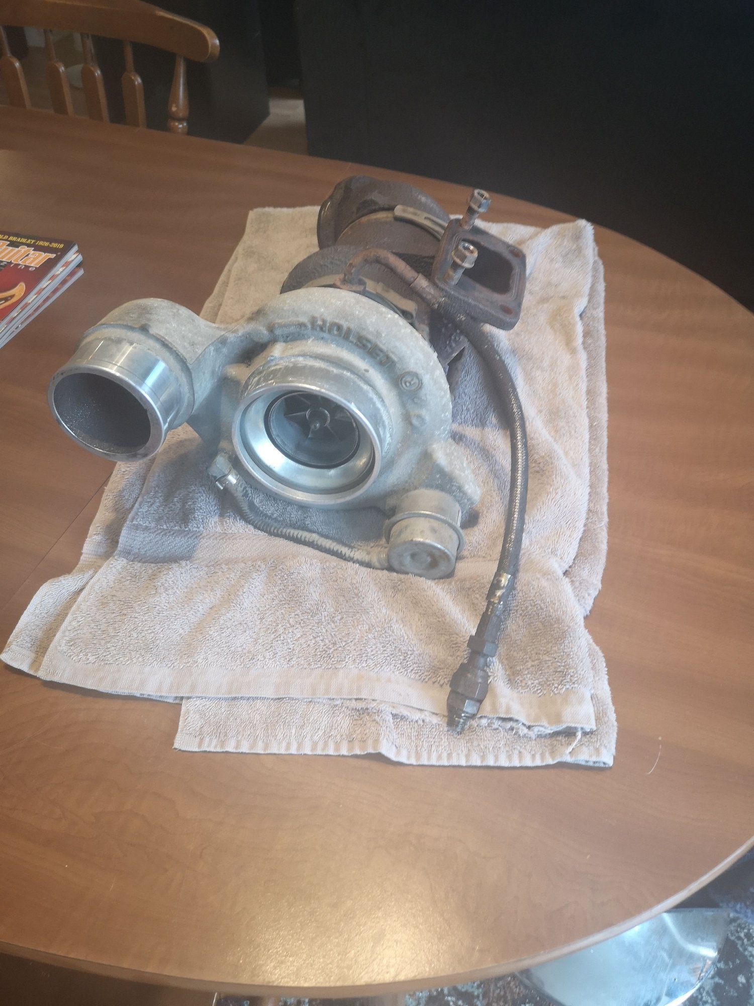

Holset from a 2003 Dodge Cummins picked up for $200 Canadian locally, small amount of shaft play but for the price of a rebuild ($100 Canadian) it will get a full rebuild and refresh, that all the updates for now! Stay tuned

Thanks! I'll have to look up the oil galley mods you're referencing, is there a thread already started you could point me to on the subject? I'm not sure where to begin looking. I Checked the stock online in my local scrapyard and they have lots of 1990s-2000s dodge trucks and Vans in stock so I will keep an eye out for the larger 360 magnum heads. Would it be worth nitriding and hot tanking the crank? It will be getting new bearings, that's why I ask. I had a chance to take the turbo apart a little on my kitchen table to inspect some simple parts, from what I gather from online this has a 76.5mm compressor turbine, which is slightly larger than I anticipated, but will still work great. It just means my boost will be created further up in the RPM band than planned. My seat of the pants guess would be somewhere in the 2600RPM range, depending on the heads I use and the efficiency of my homemade headers. Scrapyard run tomorrow possibly will keep you guys posted!

Got the turbo apart at work today, I'm under the assumption that someone may have upgraded this in the past. The compressor wheel is 78.5mm and the exducer wheel is 62mm, much larger than a normal hy35? Either way I took it apart and sandblasted and painted the housings, gutted the whole deal and now I'm just cleaning everything like a **** and waiting for the rebuild kit! No photos yet but I will get some once the whole deal is together and looking like not just a scrapyard turbo.
