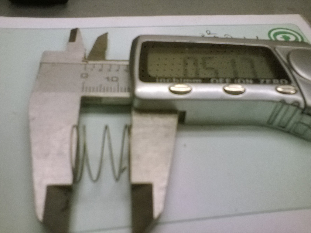

I took my bowl vent spring out for pictures (Pic 1 and Pic 2). I found a company online that sales a replacement spring (Part # 66-100) but, I don't think that will fix the problem. I measured mine and it seem to be similar to whats in their catalog (Pic 3)
My spring measurement
ID .5
diameter .013
length .517
4 turns/coils
