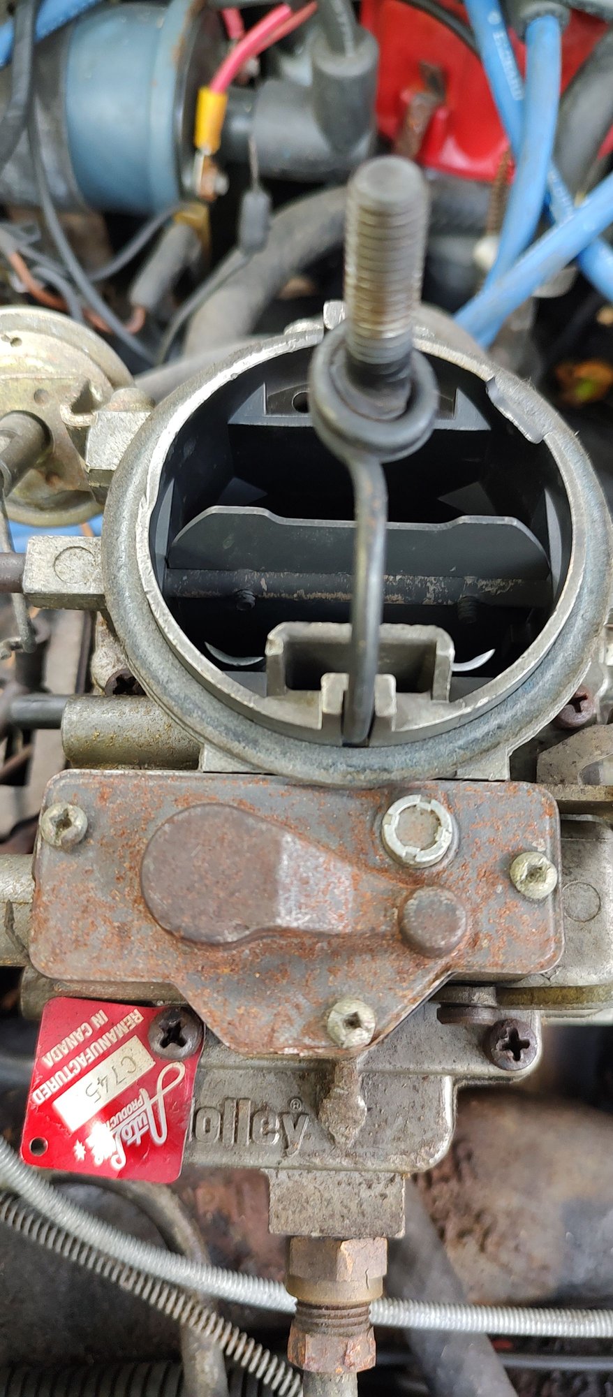

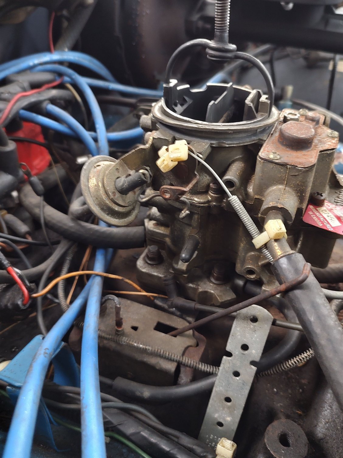

I am just starting to peel back the layers of WTF is going on here. Lol. I was wondering if anyone knows what Holley carb this is, guessing it is a c745, and point out anything else funky going on, besides the zip tied choke. I had to resize the pics, if you want/need the full resolution let me know.

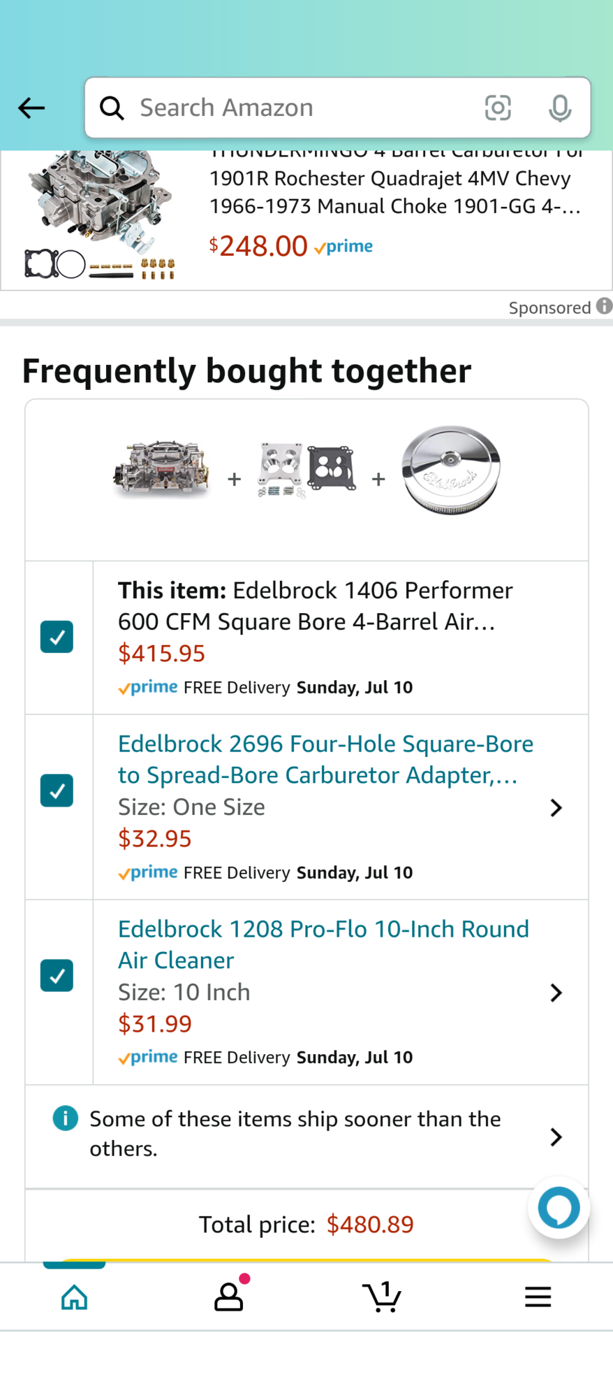

Guessing this is a good replacement....
Old Jul 9, 2022 | 07:08 AM
Posts: 11,104
No, That is a holley R40093,, 2 barrel Carburetor.. The RED TAG is from the rebuilder there in Canada...
The carb you have selected will not work without purchasing a intake manifold as well...
Manual choke is ok, You can work on the thermostatic Choke set up later down the road. Looks all their, just may not have been working correctly

Oh... So we only have a cold start drivability problem?
I think i see what some of the problem is... " As long as the choke opens and closes fully?"
On the opposite side of the carb is that 1/4-20 nut on the choke shaft..... It is suppose to have a lever and a rod that goes down to the Lower Step Cam. >>>> That is for the fast idle when you have the choke closed and partly open. (Question is, Do you still have those pieces?)
I think I'm missing those parts! I will see if I can source them and get a rebuild kit at the same time.

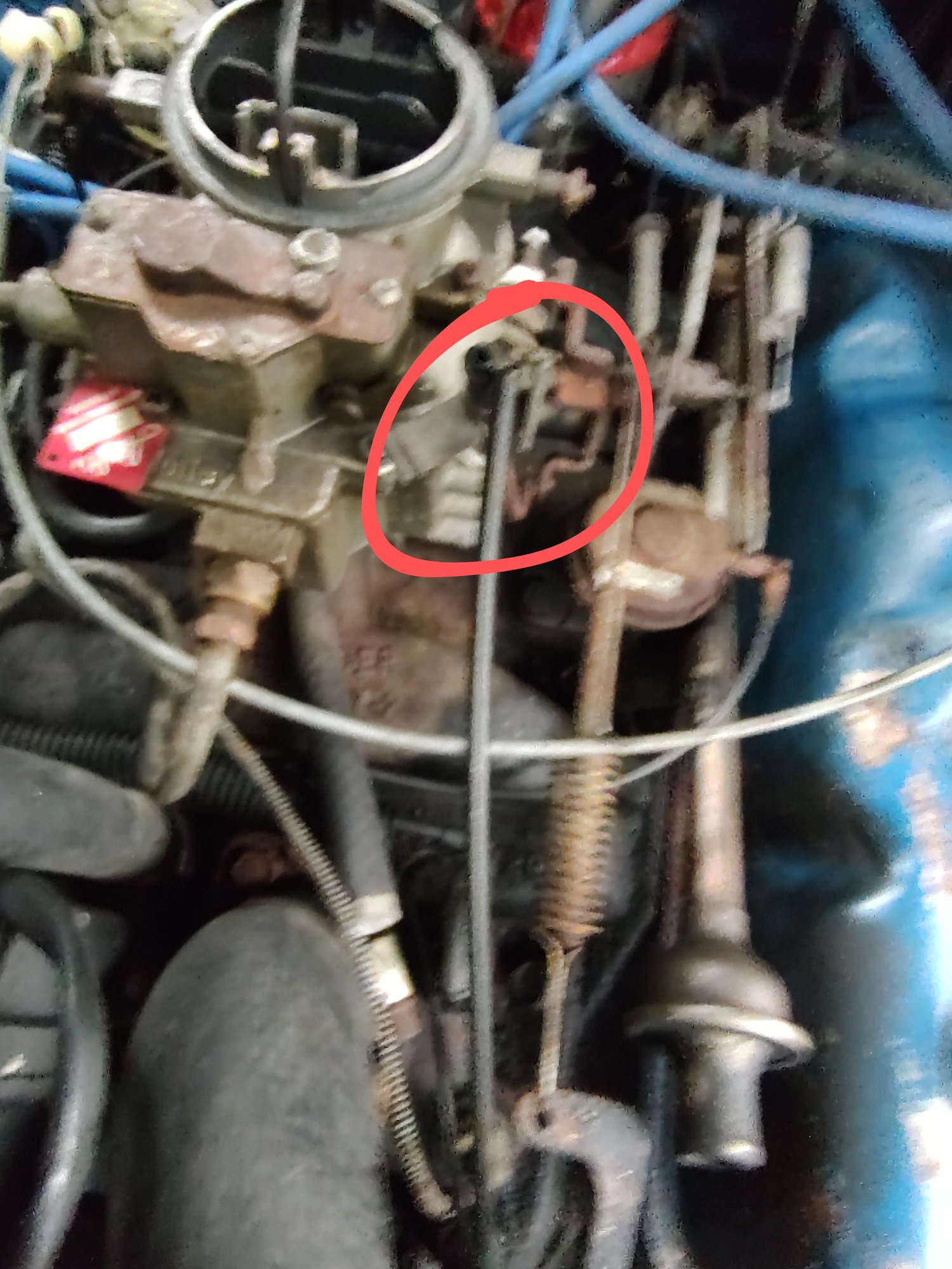

This rod?
Old Jul 12, 2022 | 06:39 PM
Posts: 11,104
If you installed the Choke cable kit? The little lever may have come with it.... Then you can just make the rod with a coat hanger...
I'll see if i have a photo on my other PC when I get to the house...
Old Jul 12, 2022 | 06:43 PM
Posts: 11,104
Originally Posted by Polie
This rod?
Not, that rod gose to the choke bar that the tie wraps are connected to... That to open the choke slightly until the thermo coil that is dowm below that in the intake manifold...

If you can just find the lever that fits where the 1/2-20 nut is and a rod.. I think your cold start / run problem may be solved...
If this site works for you. you can get the general Idea of how that is hooked up... Not your carb but you can get the idea how its supposed to be working...
https://nationalcarburetors.com/Chry...45_p_2227.html
