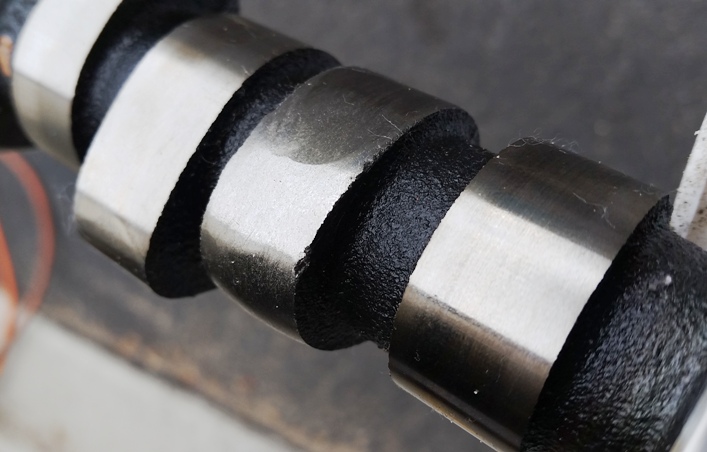

Hyrdaulic lifter and Cam bad
After removing the cam I found that the #8 cylinder intake lobe (see attached) has worn badly. It had next to nothing as far as lift. Just curious as why only the one lobe has gone bad?
I did an inspection on the top and bottom of the engine and found no metal. I only found a fine sludgy substance at the bottom of the oil pan.
So I went ahead and replace the cam bearings and cam. Now ready to put 440 back together.
Is it necessary to preload the lifters with oil before installing them?

I always submerge mine in oil and leave them in oil overnight. Be sure to use a quality engine assembly lube. Some cams come with the lube they want you to use.
Old Aug 11, 2015 | 01:46 PM
  #25
Check the fit of the lifter in the bore, Maybe just a tad too tight & not rotating enough ????
