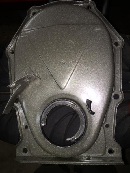

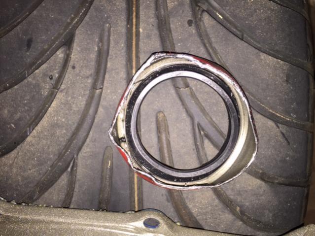

Problem Figured Out!!!
OK, figured out the problem!!!!!!!!
Here is what happened.... Back when I first put the newly built motor in the car, I was having heat problems...
I had an underdrive aluminum pulley on the crank which I thought was not spinning the water pump fast enough..... so I bolted the STOCK crank pulley back on...... however, when I did, I used the bolts that were off the aluminum pulley..
Little did I know these bolts were TOO long for the stock pulley. When I screwed the pulley on with these bolts, they went THRU the harmonic balancer, gouging the timing cover. When I tired to start the motor when this happened, it was so gouged in there the motor wouldn't even turn over.
I finally figured that out, but at that time, apparently the damage was already done. At this time, I had no idea I had done any damage...... well, until this noise started.
When I gouged the hell out of the timing cover, it shoved the gasket IN towards timing chain......
Eventually the chain / gear must have started eating away at the gasket, and eventually yanking it into the timing cover completely.
Luckily, when this happened, I caught it right away..... it looks as if the only damage was to the timing cover and gasket.
Talk about a close one. New gaskets and cover have been ordered and should be here Monday for re-assembly. Live and learn I suppose! My fault completely!
See the attached photos!
~Phil

Good find, I am assuming you meant to say seal not gasket...Thanks for letting us know what you found...Bill

Yes... crank seal, not gasket
Now I'll get it all back together, and flush the motor a dozen times to make sure nothing is floating around anywhere that it shouldn't be!
