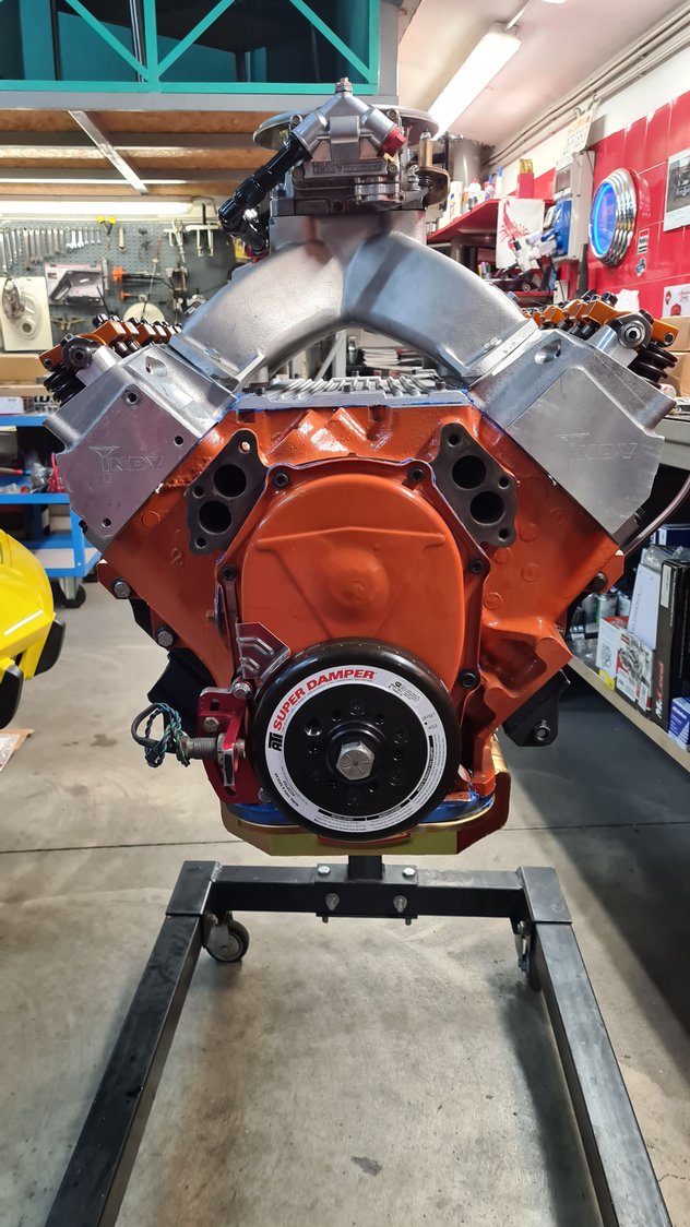

Hi Guys i recently installed in my Cuda the new 512 Engine .. after 2 month and 1000 miles i found this problem , the oil pressure is perfect at cold 80 psi and when motor is hot 190/200 F drop to 25 at Idle and 60 at high rpm .. If you push the gas in neutral at 5000 rpm the pressure go down from 60 to 40 ... at 30 psi can depend from cavitation ?? i had a 496 with same oiling for several years and never made a problems
this is my engine specs :
512 is ultralight rotating is 440 source 4.25 stroke on 1971 440 block
indy 295 EZ heads with oil restriction

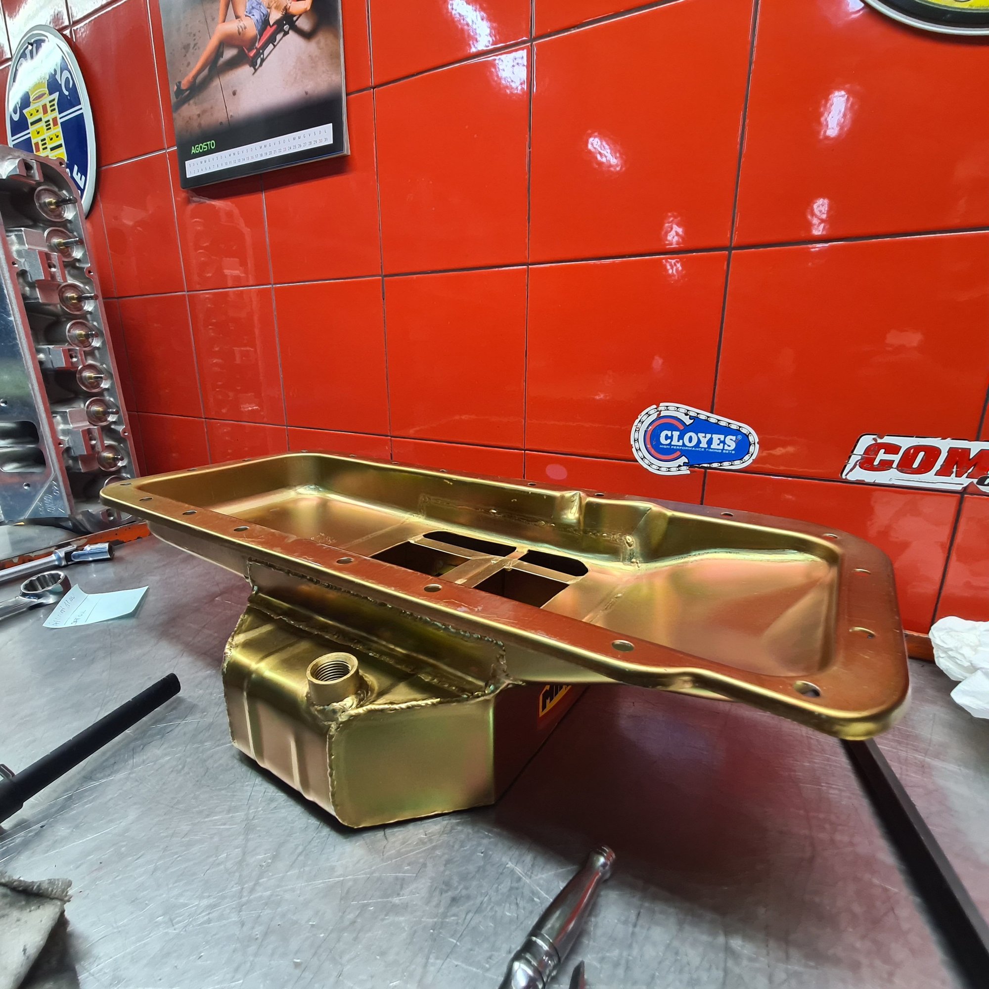

milodon external oil single line ( rear pumo flange ) oil pan is milodon 7 qt , oil pump billet milodon with external regulator
comp cams hydraulic lifters with 25wit258 050 cam
Thanks !

hey Man ! im good ! i hope you ok ! i use vr1 valvoline 20w50 .. main bearing is grooved coated clevite , clearance is .0025 .. also camshaft have grooved bearings , hydraulic lifters runs at 7300 rpm with no problems... friday i talked with milodon tech service ... told me this problem is caused by too much wind in the pan

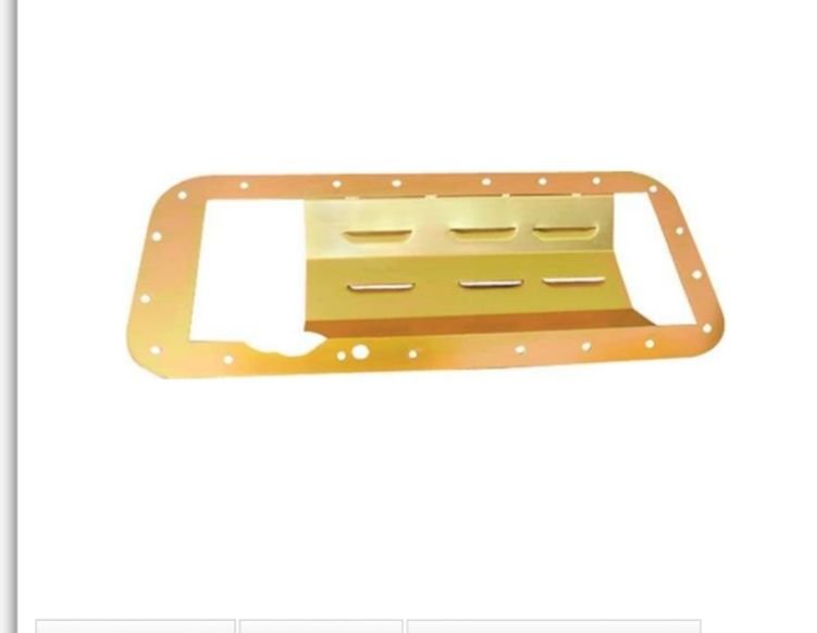

Did they (Milodon) recommend a "Windage Tray" or a "Vacuum Pump" ?
I would go the windage tray first if possible . Or will one not work with that oil pan?

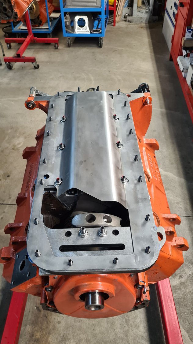

the pan was installed without tray ... because was difficult install for the crossbolt room space , now i have modified a stock windage tray
Old Feb 21, 2021 | 01:44 PM
I would recommend modifications to the stock tray similar to the Milodon tray, I have done this to several.
One more row through the middle and open the side slides slightly deburring the openings.

I Guys look like problem solved ... with windage tray and same pan with single external
cold 80 psi
warm Idle 25/30 psi
3000 rpm 50 psi
7000 rpm 65 psi
