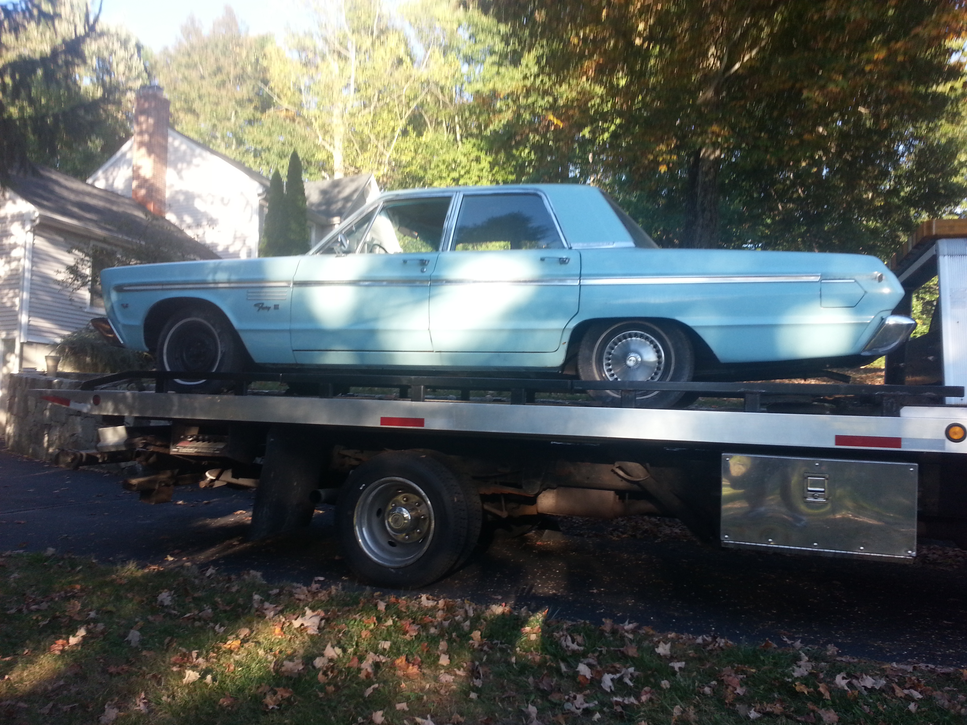

hello i have a 65 plymouth lll it has the 318 motor but sure if it is a A or LA how can i be sure the valve cover has 2 bolts and it is scalloped shaped.where do i find the numbers to tell me what this lady is.thank you

A wide block 318 not an LA
because I'm learning about this stuff how do you know?when i order parts at the local auto store do i need to tell them anything about this type because i wanted to order vale cover gaskets and these that i have didn't come up in the look up?thanks so much for the help

We can't tell you about the computer at the parts store but that is NOT a LA 318, they were called a 318 poly.

For polyspherical combustion chambers, http://www.1962to1965mopar.ornocar.com/poly318.html

Just order your parts.... Make, Model, and engine size.... Parts come up just fine.
This is your valve cover gaskets. >>>>> http://www.oreillyauto.com/site/c/se...&make=Plymouth
