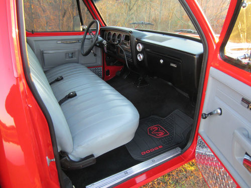

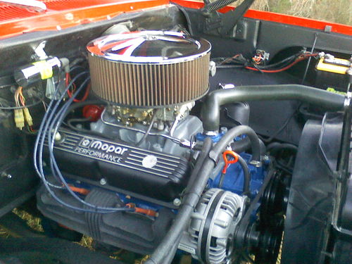

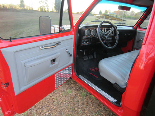

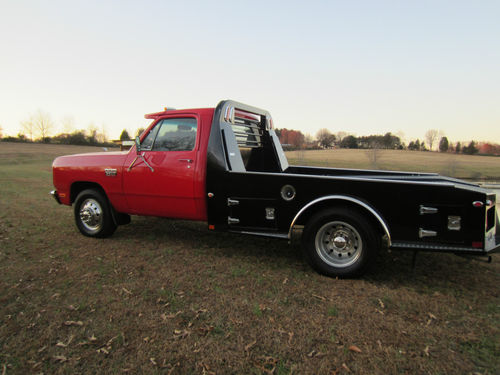

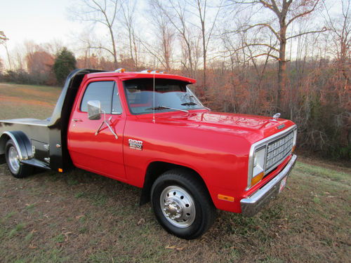

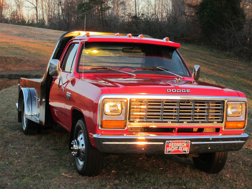

Here is some pics of a 81 Dually I did, it might help on your thinking. I did it about 7 years ago, and just sold it a few months back.
