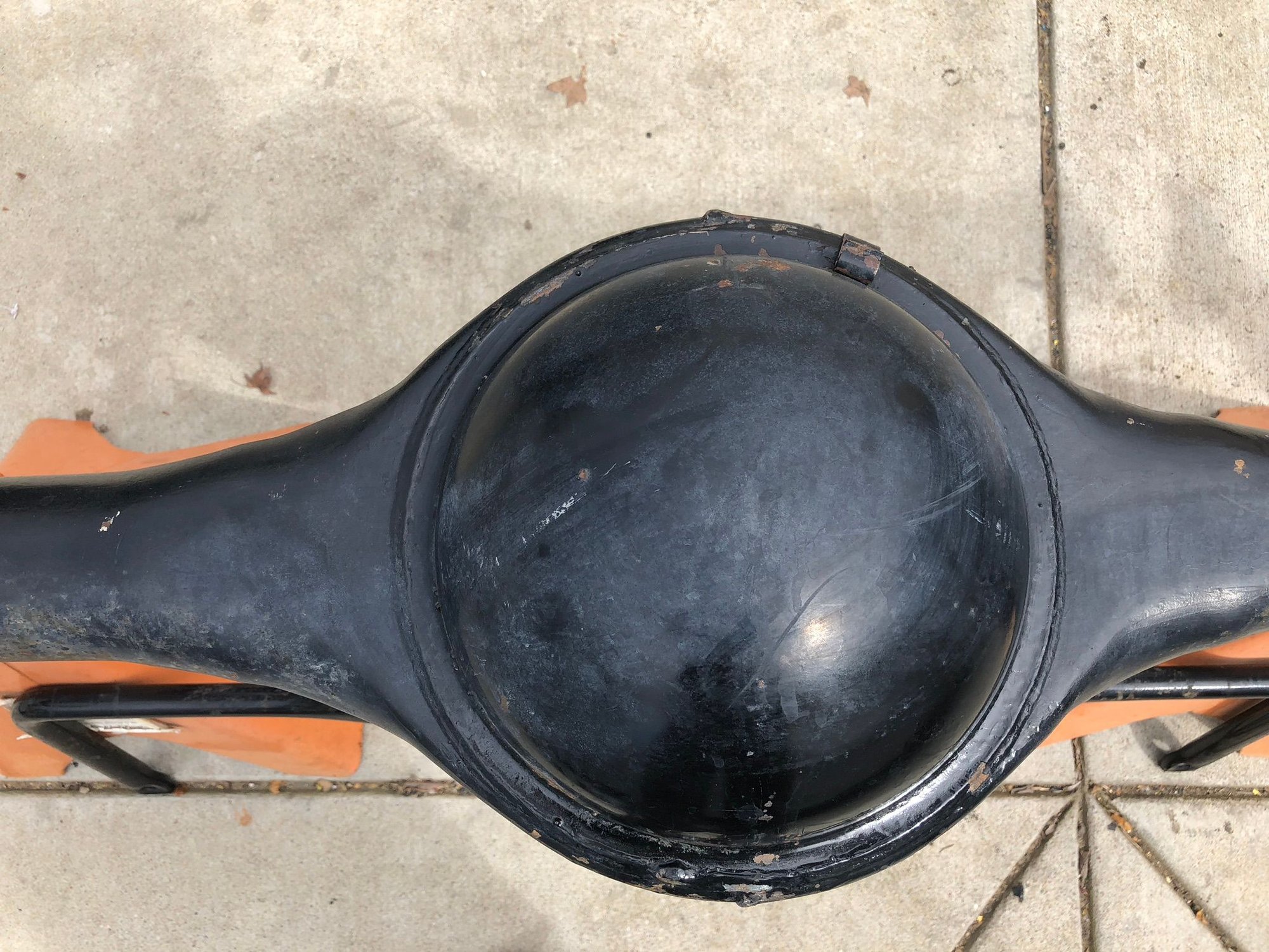

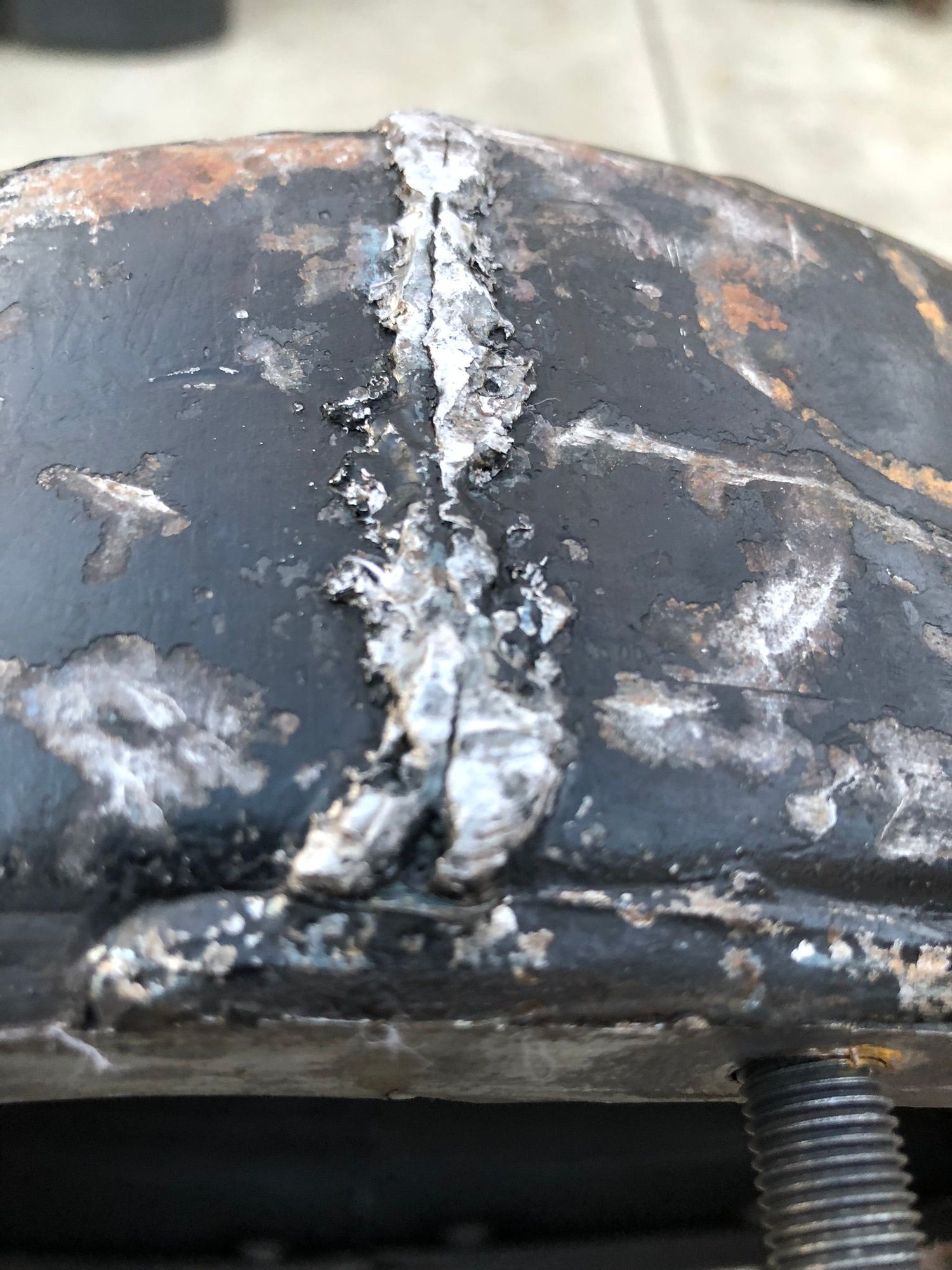

Not sure if this is normal but to me it doesn't seem like it. I will try to post the pictures of the housing seams that are welded on the inside and outside but there is a split in each seam. Both the inside and outside ones are all the same.
Housing came out of the car running just fine, no leaks.
This came out of my 70 RR
Can you guys let me know what's up with this?
Thanks!

That does not look factory, original welds can look sloppy but to me that looks like a stick arc weld that is cracked.
Old Apr 4, 2018 | 10:49 AM
Looks to me like its just a sloppy old weld... I'd grind it, Clean it, and reweld it, if it was going in my car.... Just my 2 cents...

It is crazy that all 4 welds are cracked. The pumpkin face and back side are totally fine which really confuses me.

Sounds like a common change over.....
Before you weld that housing, Make sure it is straight from end to end....
Should be ok as long as your not putting gobs and gobs of H.P. to it...

I've seen that type of weld before, on frames sub frames and suspension parts etc. from the 50s and 60s. The worst part is to put down a nice weld your going to have to remove all the weld you now have. Otherwise you get more **** weld.

I brought it to "The Rear End Shop" and Barry told me that is normal and it should be fine but may want to weld it up but make sure it's straight.
I guess I will put a digital level/protractor on each end to see if it's straight then grind down the welds, V-notch them a bit then fill with stitch welds so it does not warp.
