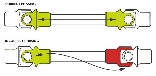

Check driveshaft phasing (easy)

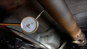

Check Shaft Run out with a dial indicator

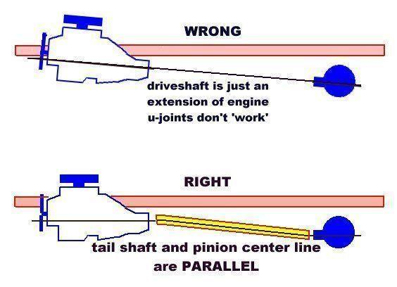

pinion angle (not so easy without a drive on lift)
